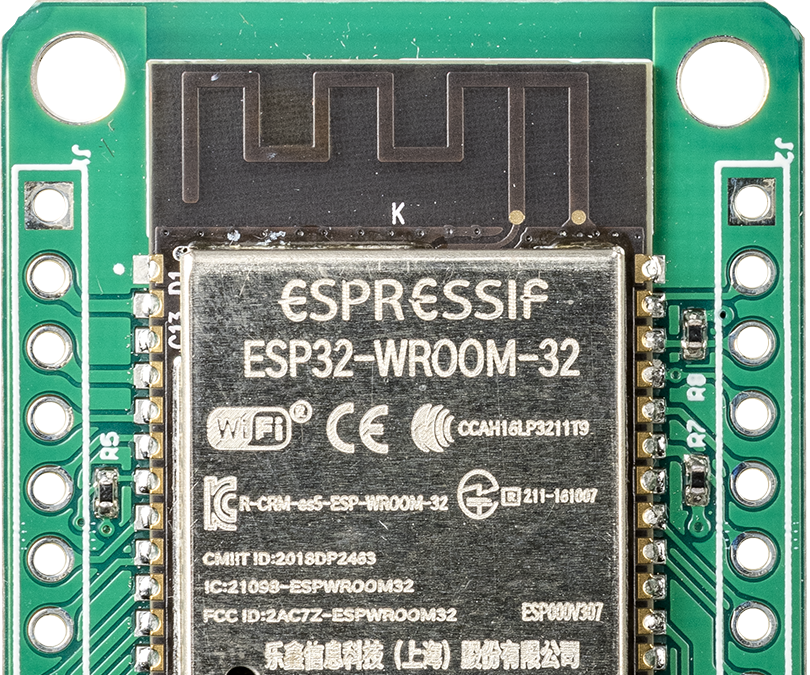

The Complex Arts Sensor Board (complexarts.net) is a versatile microcontroller based on the ESP32 WROOM. It has all the features of the ESP32 platform, including built-in WiFi and Bluetooth, and 23 configurable GPIO pins. The Sensor Board also features the BNO_085 IMU – a 9 DOF motion processor that performs onboard sensor fusion and quaternion equations, providing super precise orientation, gravity vector, and linear acceleration data. The Sensor Board can be programmed using Arduino, MicroPython, or the ESP-IDF, but for this lesson we will be programming the board with the Arduino IDE. It is important to note that the ESP32 modules are not natively programmable from the Arduino IDE, but making that possible is very simple; there is a great tutorial here: https://randomnerdtutorials.com/installing-the-esp32-board-in-arduino-ide-windows-instructions/ that should take about 2 minutes to complete. The last piece of setup we need is the driver for the USB-to-UART chip on the Sensor Board, which can be found here: https://www.silabs.com/products/development-tools/software/usb-to-uart-bridge-vcp-drivers . Just pick your OS and install, which should take about 2 more minutes. Once that's done, we're good to go!

Next, we assign the proper pins of the ESP to their respective pins on the BNO.
Now we set up the SPI class member, also setting the SPI port speed.
Finally we get to the setup function. Here, we’ll start a serial port so we can monitor our output that way if we want to. Then we begin WiFi. Notice that the program waits for a WiFi connection before proceeding. Once WiFi is connected, we begin the UDP connection, then print our network name and our IP address to the serial monitor. After that we start the SPI port and check for communication between the ESP and the BNO. Lastly, we call the function “enableRotationVector(50);” as we will only be using rotation vector for this lesson.
