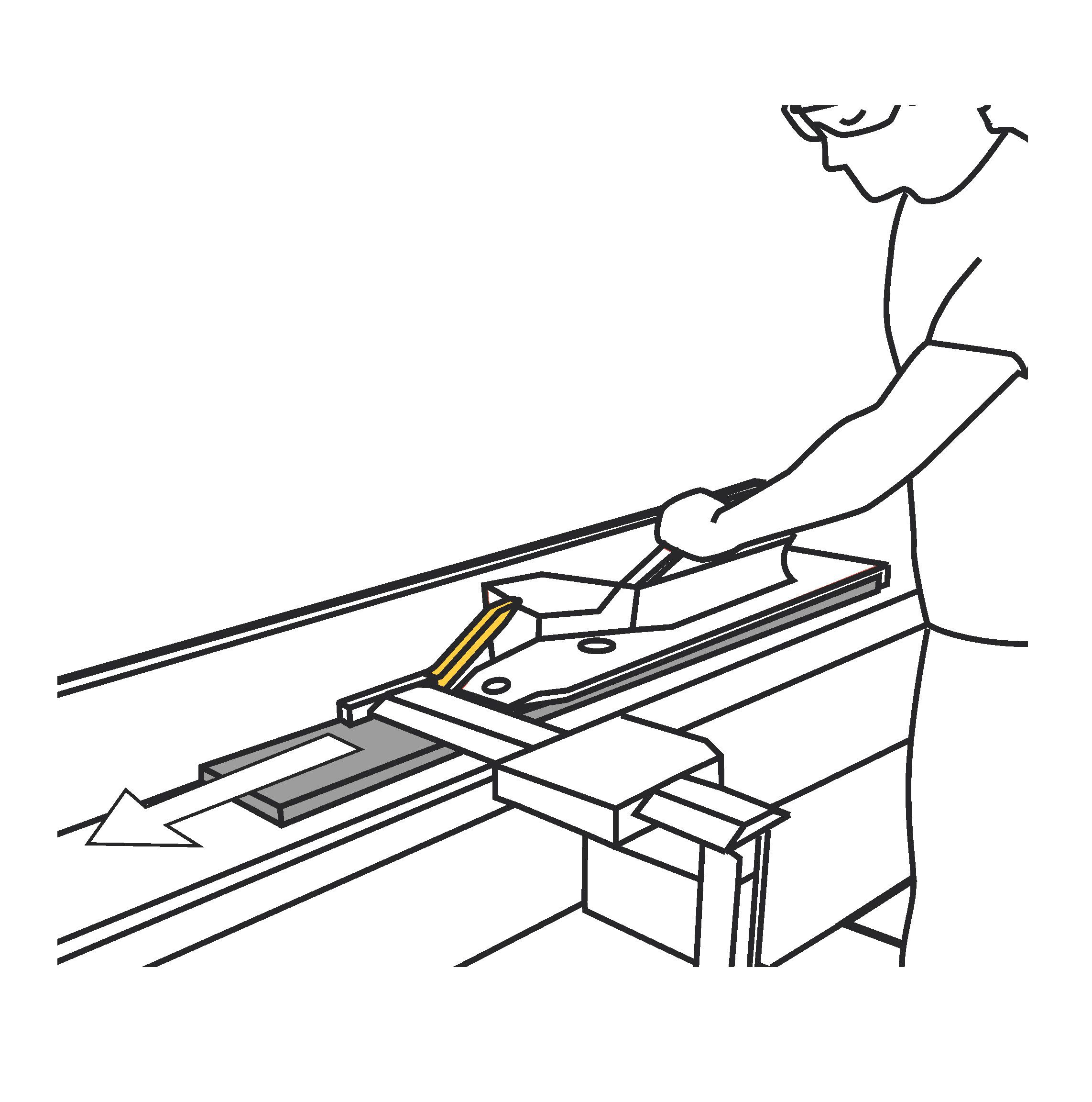

Step 2: Using the Large Capacity Push Stick
The large capacity push stick is the best tool to use for jointing the face of a wide, thin board. It should be used with any board 1" thick or less.
- Place the large capacity push stick flat on the board.
- Put the yellow arm in the vertical position.
- Push the board through, using the handles on the large capacity push stick.
- When the plastic blade on the large capacity push stick hits the yellow arm, the arm will move to the horizontal position.

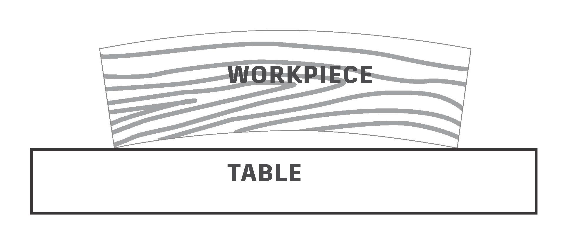

Step 5: Machining Curved Hardwood
If the board is bowed, warped or cupped, place the high point up. It may take multiple passes to make the board flat. If you are working from Pier 9, ask Shop Staff for best methods. If you are working from a different studio, refer to the jointer's manual for best practices.
