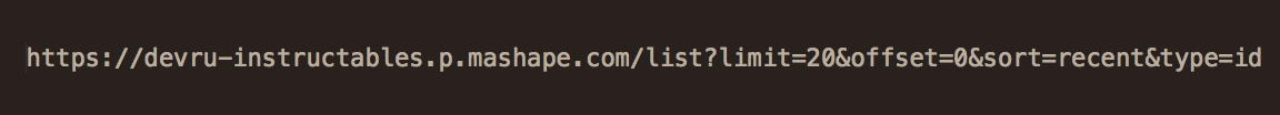

Heres the base URL plus the path for the Get List endpoint.
URLs can also contain queries that add specificity to a request. For example, requests made to the Get List endpoint can include query strings specifying the number, offset, sorting method, and type of Instructables returned (see green brackety looking thing in the screenshot).
Query strings are placed in a URL after a "?" and tacked together with "&"s.

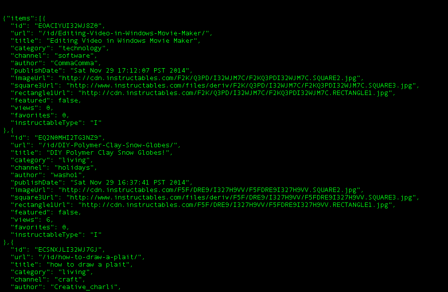

Here's our Get List URL from the previous page - https://devru-instructables.p.mashape.com/list?limit=20&offset=0&sort=recent&type=id. Hopefully, upon receiving a request to this endpoing the server will respond with a list of Instructables, like in the example Mashape provides (screen shot above). Click it and see what happens!
Wahn Wahn Wahn Wahhhnhnhnhn - get something like this?
Two problems - 1) presumably, you haven't yet registered for an API key, and 2) you can't pass you're API key to the server via the browser.
API keys are sometimes required so that API user can be monitored and the rate at which they make requests can be limited.

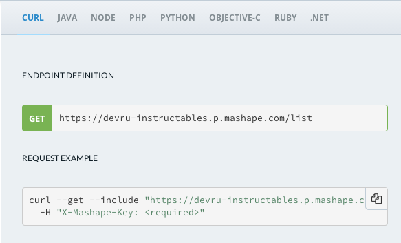

Let's take a look at the screenshot below. First, you can see CURL is selected from a list including some names you might recognize as popular programming languages. Mashape provides examples for making requests to the API via several platform, and we're looking at CURL, a command-line tool (for Mac users, that means the Terminal).
On the second line of the request example you can read '-H "X-Mashape-Key: "'. The "-H" stands for "header", and everything after it will go in the header of the request sent through CURL. The header is part of the web request made to the URL that we can't set when we make our request browser. If we copy and paste the request exampe into the command line as is, we get a response in the terminal like this.
"Invalid Mashape Key" because we tried to pass "required" as a key. To get your key, you'll need to make an account at Mashape.com. Once you do - you can replace "required" with your unique API key, and you'll get a response that looks something like this.
