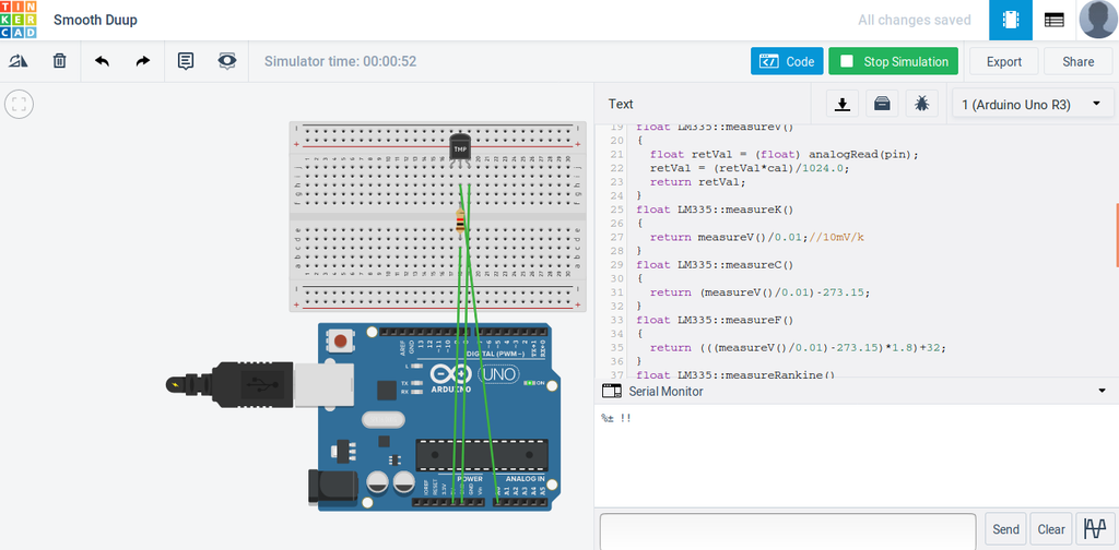

I tried out this on Tinkercad. I think the code fails to work there.
