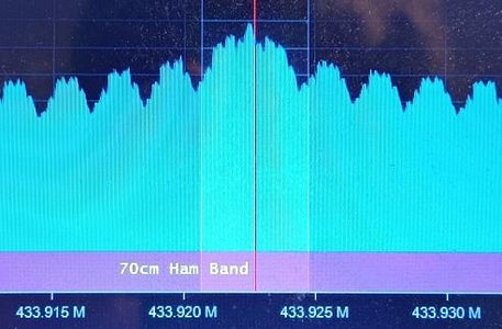

(1) The below sketch uses bit-rate of 2000bps (this is the actual bit-rate of the transmitted signal). I use an RFM69 OOK Channel-Filter bandwidth of 3.9kHz, but I have not optimised this. (It will also work with Channel-Filter bandwidths of 83kHz or higher, which allow a larger RF frequency tolerance when testing.)
(2) The WL102-341 module transmits OOK with a number of sidebands, as shown in the plot (the wider the Channel-Filter BW used the more sidebands are covered). Note that this OOK signal from my WL102-341 can be received by the RFM69 when set to a frequency anywhere between approx 433.923MHz +/- 4kHz (if using a BW set to 3.9kHz), or the order of +/- 100kHz (if using BW set to 83kHz). (I suspect that if the 3.9kHz bandwidth filter had an infinitely sharp cut-off, the above frequency tolerance would probably be only approx 433.923MHz +/- 2kHz, but with a sloped-cut-off and a near transmitter you get a higher +/-4kHz working allowable frequency tolerance.)
(Note that the two markers shown on the plot are +/- 2kHz from the centre-line.)

(3) Notwithstanding the above, the frequency of the RFM69 can be tuned slightly for optimum performance. eg:
#define RF69_FREQ 433.92300 // for my devices with OOK@2000bps, BW=3.9Hz DCC=4% // still works for frequency varied over approx +/-4kHz (BW set to 3.9kHz) or +/-8.5kHz (BW set to 7.8kHz)
Also note that the optimum frequency may move a little depending on the Channel Filter RxBw you use. (I suspect this may be because of the way the RFM69’s “Low-IF” is adjusted dependent on the RxBw.)

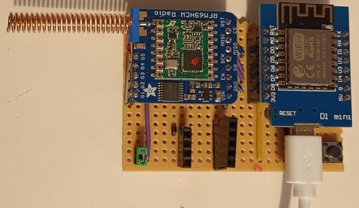

(5) I am using an ESP8266 (D1mini), but this code should work with any sufficiently capable arduino-type microprocessor. The photo with the posting shows the ESP8266 and RFM69HCW mounted on strip-board.
