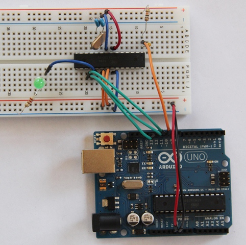

Step 3: Set Your Breadboard Up
Keeping it all together
I've used a rubber band to hold my Arduino onto my breadboard. This prevents any accidental shorting of contacts on the underside of the Arduino, and keeps it attached to the breadboard - you can't accidentally de-wire your whole project if the breadboard wanders too far from the Arduino!
Position the Motor Driver
Place the TB6612FNG breakout board onto the breadboard. It needs to straddle the break down the middle of the breadboard so as to keep the two rows of pins on separate circuits. The one side of the driver board handles inputs, and the other outputs.
Power Rails
My breadboard has 2 power rails - I use one (the top one in the images) to provide the Arduino/TB6612FNG power, and the other (the bottom one) to provide the Motor's power. You need to drive the motors from a separate power source as the current the motors draw is likely to be too much for the Arduino to handle. You must connect the GND from the two sources to ensure a common ground.
Images:
1. Mounting the breakout board
2. Overall circuit diagram
3. Physical circuit, motors and motor batteries off-frame (note the jumper cable on the left connecting the ground from the two power sources)
Power Rails
Images:

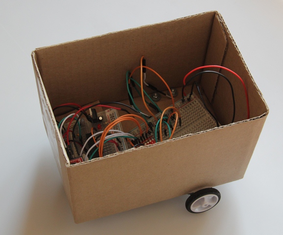

Step 8: Final Assembly
We've now connected everything we need to from an electrical perspective:
- Arduino to the TB6612FNG breakout board
- Breakout board to motor power and diodes for back EMF protection
- Motors to the breadboard
We now need to put it all together onto a simple body:
- 2 wheels mounted to the motors
- a third caster wheel/ball that moves freely
- space to hold the breadboard, arduino and batteries
Here's what I came up with - you could work this with anything from lego to meccano to a simple plastic punnet / cardboard box.
