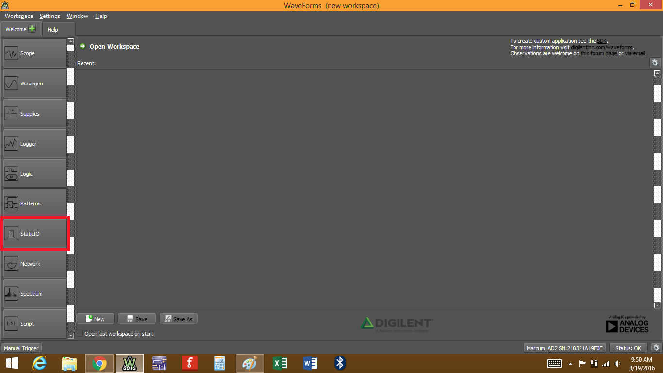

Once you have your AD2 and Waveforms all set up, open the Static I/O by clicking on the "Static IO" button.
The Static I/O window will open.

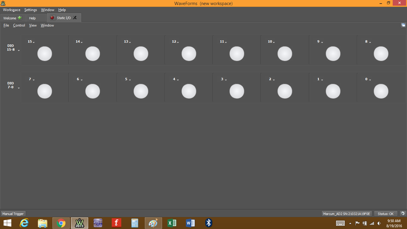

The first thing to note here is that unlike other tools, the Static I/O window opens with the tool running, as illustrated by the icon in the Static I/O tab at the top of the Waveforms window.
By default, none of the digital pins are set as outputs, so you shouldn't have any immediate issues with shorting but you should be aware that the pins are active. I recommend stopping the tool before doing any pin re-configuration.
There are two main areas: control options are at the top, and the channel configurations take up the bulk of the window space.
At the top you have a few options.
"File" lets you Save the current Static I/O project, Open a saved project, or Close the Static I/O tool window.
"Control" gives access to the tool's Run and Stop commands.
Under "View", there is one setting for turning on names for each I/O pin. With "Show name" checked, a small label box appears below each pin with a default name that matches the label on the 30-pin header. This name can be edited to identify the signal as it applies to your application.
Channel names can only be applied to individual channels when you have access to them. Some settings group all 8 channels into one reading, in which case you can't change the name. More on that in a bit.
"Window" lets you browse between any Waveforms tool windows you may have open, as well as the Help screen.

Each digital channel is set as an input, specifically a virtual LED, by default. A logic high value on any pin turns on the corresponding LED in the window to reflect the change in state on that pin in real time.
The AD2 has 16 digital logic pins, labelled 0-15. They are broken into two groups 0-7 and 8-15. On the left side you have some controls for each group of 8.
"Bit IO" is checked by default and lets you set the whole group of 8 pins as the same type.
Selecting "Last IO" resets all 8 channels to the last setting of each channel if you were to switch the whole group to one of the bus options.
"LED" is the default and sets all channels to inputs with a virtual LED displayed. The LED will light when a logic high is detected. The AD2 defaults to 3.3 V for logic high for both input and output, but all digital pins are 5 V input tolerant. In the event of accidental overvoltage on one of the digital pins, up to ±20 V overvoltage protection is supported.

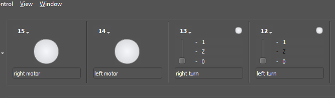

Each channel can also be individually configured for LED, button, or switch by clicking on the small number
associated with each channel. Only that channel will be configured, letting you configure any channel however you want.
Below "Bit IO" in the group control you'll see "Slider", "Progress bar", and "7-segment". Each of these setting configures that group of channels as one 8-bit bus.
"Slider" is an 8-bit output bus. As you move the slider to the right, the equivalent decimal value will display in a small box on the right. You can directly enter any value between 0 and 255 in this box. This value will be represented in binary on the 8 corresponding pins, with the highest channel number representing the most significant bit (MSB).
"Progress bar" is an 8-bit input bus. The 8 channels are used to indicate a value represented in binary with the highest channel number representing the MSB. On the right you will see the equivalent decimal value.
The last option is "7-segment" which takes all 8 channels and assigns each to a segment in a virtual 7-segment display, including a decimal point. Each channel number is displayed on the 7-segment for ease in assigning values.
