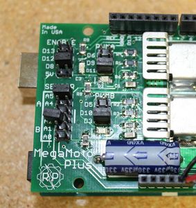

Step 4: Adding Outputs
Now that we've tested different inputs, we can see how outputs can be used in the switch() statements as well. We will use the MegaMoto to control an actuator to extend and retract. This example is similar to the first example, we're just using time delays.
See the wiring diagram, and upload the code. See the MegaMoto Instructable for more detail information about the motor controller. While the program is running, the motor will be moving, and you can watch the serial monitor to see what is happening.
Since these are just test programs, you can leave the board plugged into the computer so the Arduino can receive power.
/* This code is to show how outputs are used in a switch statement. The code moves an actuator in and out at varying speeds, according to the sequence. Written by Progressive Automations Sept 21, 2015 This code is in the public domain */ const int enable = 8; const int PWMA = 11; const int PWMB = 3;//pins for the MegaMoto int programCount = 0;//variable to move through the program void setup() { Serial.begin(9600);// initialize serial communication: programCount = 0;//start at the beginning pinMode(enable, OUTPUT); pinMode(PWMA, OUTPUT); pinMode(PWMB, OUTPUT); }//end setup void loop() { switch (programCount) { case 0: digitalWrite(enable, HIGH);//enable the control board Serial.println("Motor moving forwards at full speed"); analogWrite(PWMA, 255); analogWrite(PWMB, 0);//set the speed of the actuator delay(5000);//Move for 5 seconds programCount = 1; break; case 1: Serial.println("Motor moving backwards at full speed"); analogWrite(PWMA, 0); analogWrite(PWMB, 255);//set the speed of the actuator delay(5000);//Move for 5 seconds programCount = 2; break; case 2: Serial.println("Motor moving forwards at half speed"); analogWrite(PWMA, 128); analogWrite(PWMB, 0);//set the speed of the actuator delay(3000);//Move for 3 seconds programCount = 3; break; case 3: Serial.println("Motor moving forwards at full speed"); analogWrite(PWMA, 255); analogWrite(PWMB, 0);//set the speed of the actuator delay(2000);//Move for 2 seconds programCount = 4; break; case 4: Serial.println("Motor moving backwards at full speed"); analogWrite(PWMA, 0); analogWrite(PWMB, 255);//set the speed of the actuator delay(2000);//Move for 2 seconds programCount = 5; break; case 5: Serial.println("Motor moving backwards at half speed"); analogWrite(PWMA, 0); analogWrite(PWMB, 128);//set the speed of the actuator delay(3000);//Move for 3 seconds programCount = 6; break; default: Serial.print("Movement complete"); while(1); //freeze the program here }//end switch }//end loop
