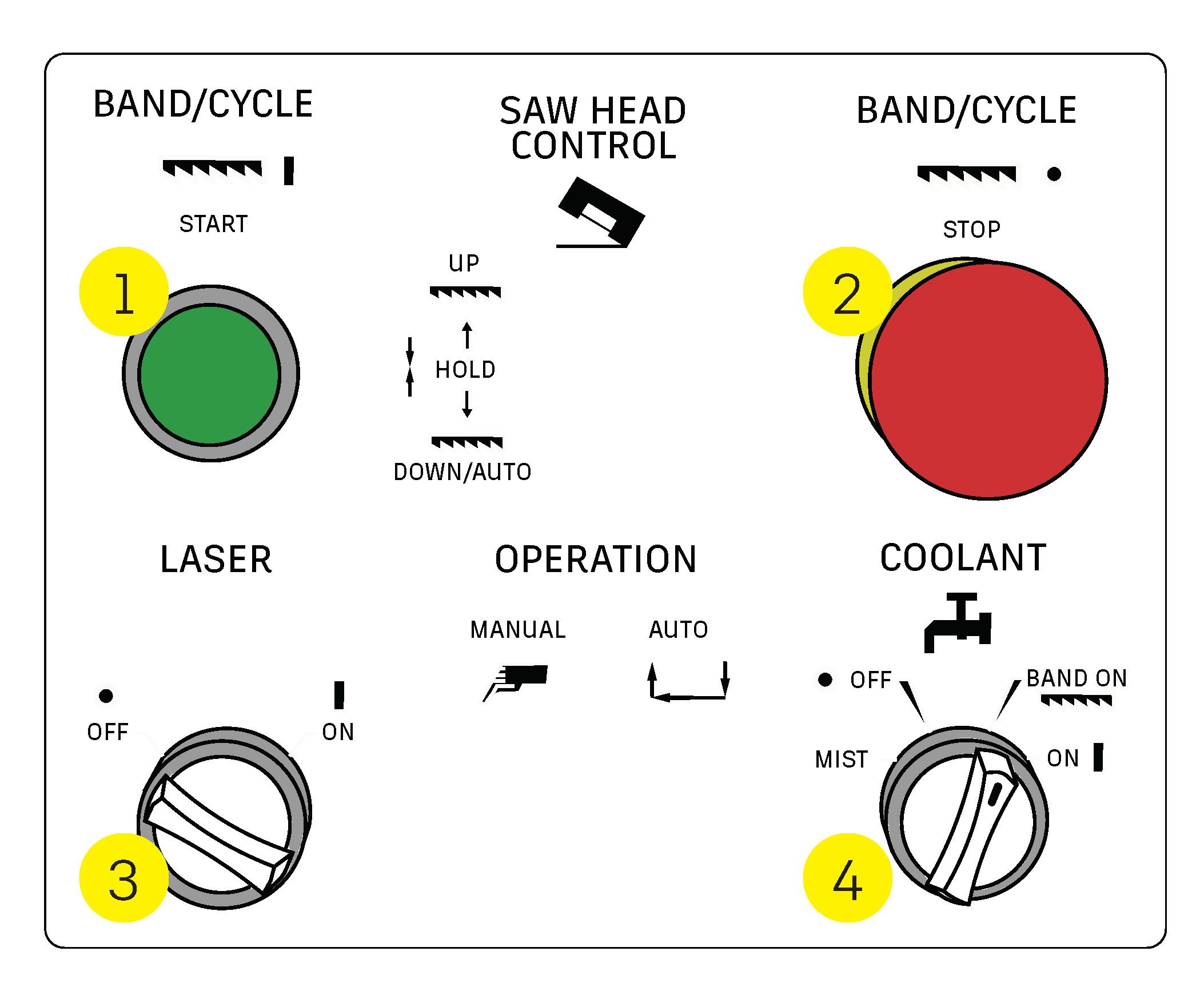

Step 2: Saw Control Panel
The saw control panel has 4 main functions.
- Start button
- Stop button
- The blade will automatically stop when the saw finishes cutting.
- Laser switch
- Use to align the blade with the desired cut line.
- Coolant switch
- BAND ON for metals.
- OFF for plastics.
