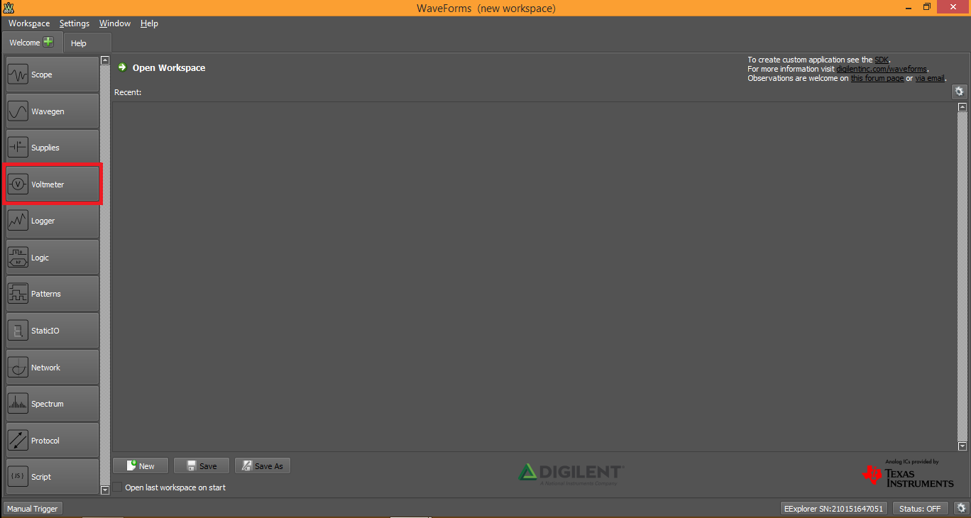

Once you have your AD2 and Waveforms all set up, open the Voltmeter tool by clicking on the "Voltmeter" button.
The Voltmeter window will open.
There are two main areas: tool options are at the top, and then the voltmeter channels take up the bulk of the window space.

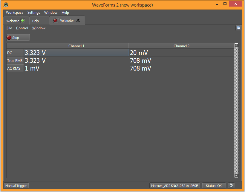

The Voltmeter tool uses the same pins that the Oscilloscope tool uses, namely the 1+/1- pins for channel 1 and the 2+/2- pins for channel 2. Simply connect the pins across the element in your circuit where you wish to measure voltage. The AD2 scope pins are fully differential, meaning that the +/- pins can swap orientation. If the signal is inverted from what you expected, be sure you have the "-" pin connected to the side of the element where you expect the lower voltage to be. The "+" pin would then connect to the side of the element where you expect the higher voltage to be. The DC voltage, True RMS, and AC RMS will all be displayed in the Voltmeter window.
The data shown above was collected using the EEBoard's Power Supplies and Waveform Generator tools and the AD2's Voltmeter tool. Channel 1 shows a nominal DC voltage of 3.3 V, while channel 2 shows an AC sine wave at 5 Hz frequency, 1 V amplitude, and 20 mV DC offset. Note that the data correctly shows the RMS value of 1 V / √2 ≈ 710 mV.

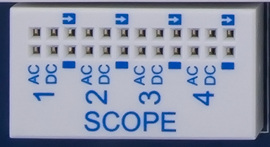

To use the Voltmeter tool on the EEBoard, use the oscilloscope pins located in the SCOPE block.
The channels on the EEBoard are not differential, meaning that the GND connection in the SCOPE block is tied to the EEBoard's internal GND plane and should be connected to your circuits's GND as well. This means that any voltage readings will be in reference to the circuit GND. If you want to read the voltage across a specific element within the circuit where neither pin is directly connected to GND, use two different scope channels and note the difference between the two.
