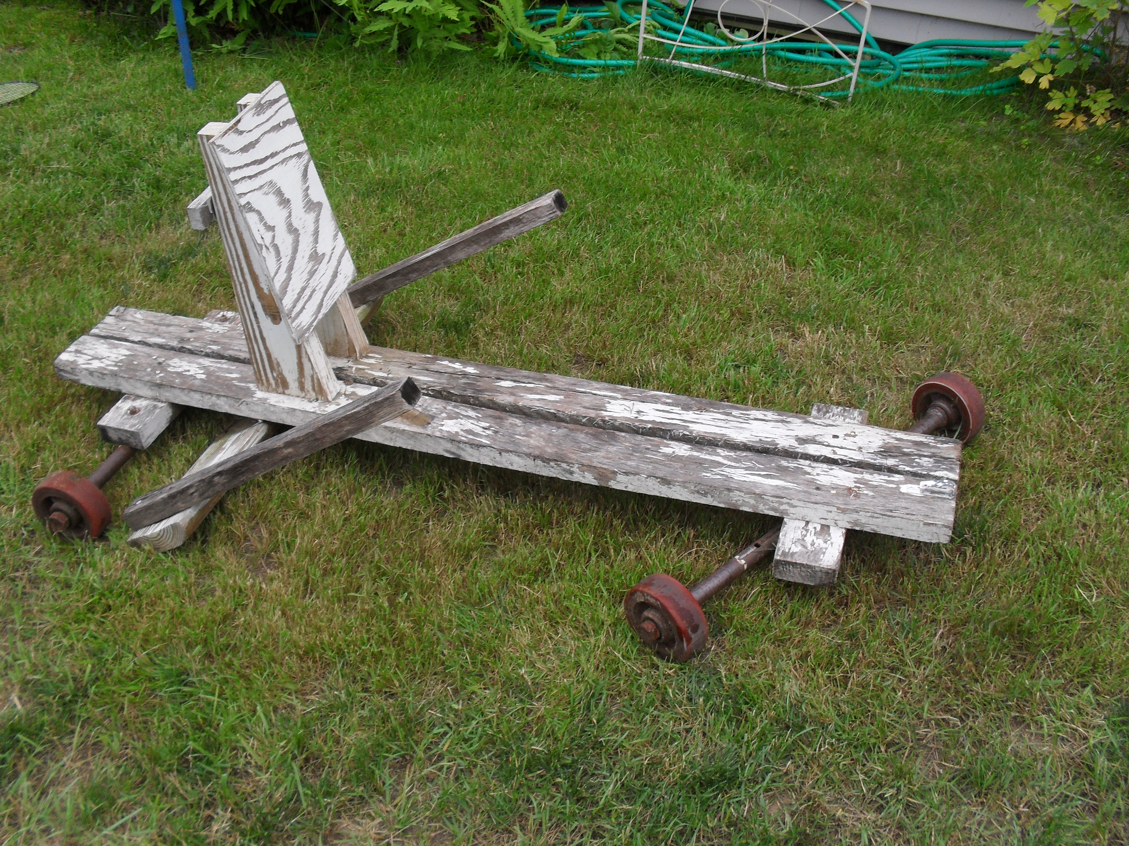

Hey everybody wanted to add some of my ideas to the world of bike trailers. Bike trailers can be very useful for different things, and for me it is carrying lawn equipment around to my job sites. I am 15 years old and have my own mini lawn care company and this trailer gets the job done so take a look and I hope that this article can help you create your own!
Step 1: Shopping List/Overview
So I started off with a sheet of 3/4" plywood and cut it to size. Mine is 36"x 24" I believe. It is a pretty manageable size to be pulling around. I wouldn't use plywood any thinner than that because I basically is the frame of the trailer, but 3/4" is plenty thick enough to support any weight you put on the trailer. also make sure your wheels balance out the load so move them to where the load will be most so that your bike trailer does the carrying not the EMT( it will bend abit over time) and your bike.

Step 2: Customization
So the next step is making it your own by adding features to it. my trailer can go from the first picture to the second in a minute because I used c-clamps to secure everything down so that I could always have the space of a flat bed but put on different racks as needed.
But always remember to take your time and cut once and measure twice!!!
Have FUN! And Leave comments and Questions if you have any(:
