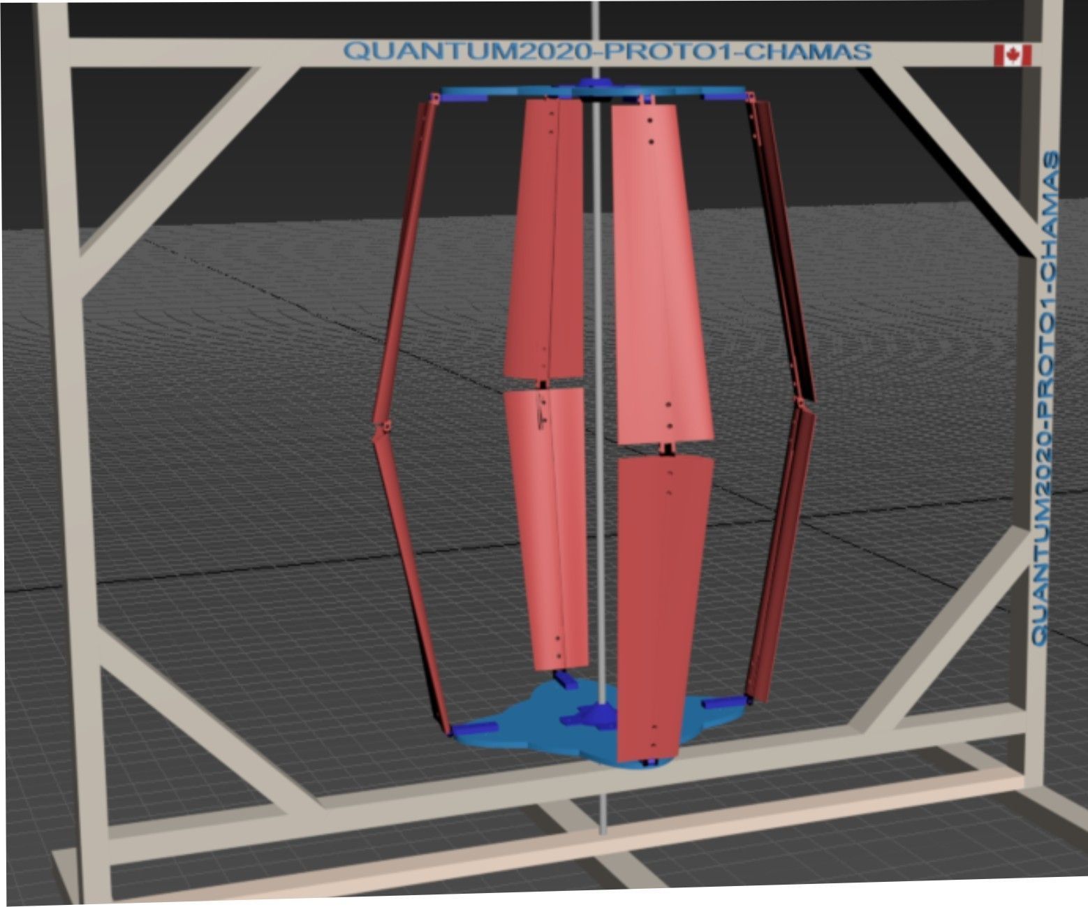

http://www.vawt.ca Guys Don't Get sick Of me, But After making the V8-3" I realized that the Vanes are not able to hold onto all the wind that comes near it, that was due to when i expanded the middel section it flattened the vanes in the middel, so i designed the V8-4" in a way that when i expand it, it retain the correct shape to stay efficent and able to use all the wind it can get. This design has the RPM and have more Blade area than the V8-3".

The Vanes are made from white 4" PVC cut to Cad Design.
I have cut the vanes to shape as designed in Cad. this design is much more effective in retaining the wind and producing rotation energy. trust me i tried many diffrent cuts and i wasted alot of money to come up with this one, so take my advise.
note: I rendered a drawing for you to see how to cut your vanes (PVC).
I hope I explained it correctly..
And A 1/8" hole is drilled at each side and it is 1" from side and 1" away from bottom.
Again you have to alternate the pvc pipes because of the flange end.
