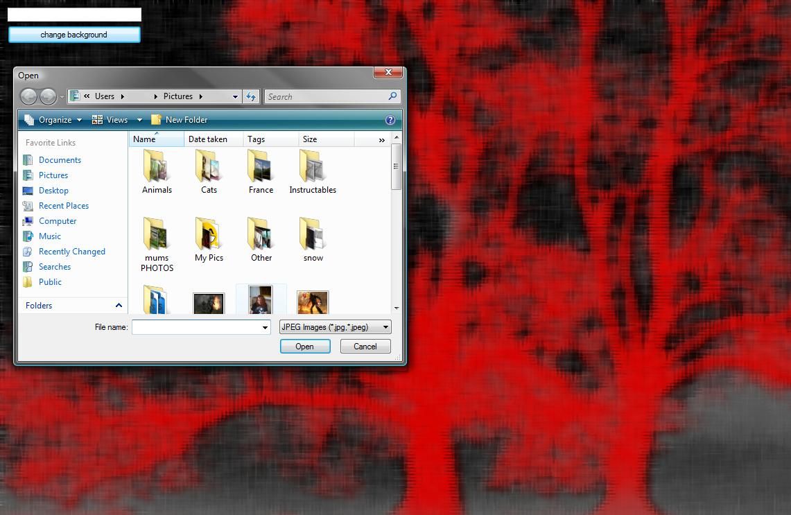

now you can start to add things to you vars .. like:
iRule=msgbox("hello")
this would make a message box pop up saying hello. (pic 1)

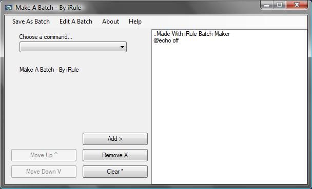

Using vars in the script..
You can use vars easily ..
you could have: (pic 2)
dim iRule
dim instructables
iRule="instructables"
instructables=msgbox("hello " & iRule)
Because of the & it says 'hello instructables' becuse the value of iRule is instructables.
