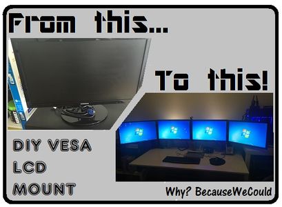

You can get large computer LCD monitors now for relatively cheap, especially second hand ones. You can start to see a decent Samsung 24" HD monitor sell on the second hand market for about $50 AUD (~$35USD), and that's exactly what lead me to this Instructable. Looking on eBay I spotted 3 Samsung S24D300BL monitors for $50 each. The Samsung S24D300BL is by no means the absolute latest Super HD 4K gaming monitor with Back-To-The-Future response times, but moreso an office orientated monitor with modest specs such as 1080i, VGA and DVI (No HDMI). Although it has its colour to colour response time of 5ms, for what it is, it's actually a hidden gem in my opinion for panel colour, quality and sharpness, 23.6" of widescreen fun for $50 each is great!
I am running a custom computer build i7 3770K superclocked with 16gb, 500GB SSD and a GTX780. The GTX780 has 4 output ports; HDMI, DisplayPort and 2 x DVI, and can simultaneously run 4 LCDs! What fun I thought. The problem then was - How would I arrange the monitors on my desk? I purchased 2 x dual desk monitor arms from KOGAN (www.kogan.com.au) for $46AUD each, good quality and an absolute steal at that price. You can also use name branded ones like Bractek or Spacedec ($$$) because the VESA mount that we will be making is a universal one:
Just a quick intro on VESA standardisation. >> VESA is the standard monitor mount system and usually works in 3 main calibrations/measurements. Monitors that are VESA compatible allow you to remove the base stand, and then screw a VESA mount to the back and run the monitor from an arm. You quite commonly see this at banks, shops and Universities as VESA mounting makes more space on the table, and allows you to more easily adjust the height and position of the monitor. VESA compatible monitors are also assembled differently, quite often completely shielded in metal to support its own weight from the screws.
I have seen a few DIY attempts of self-VESA mounting using PVC, Wood, Glue.... duct tape - you name it. I'm going to show you how to have them professionally mounted to the effect that to the naked eye it would have appeared that you spent the extra few hundred on VESA compatible monitors.
$20 of local hardware supplies, common house tools and a good DIY attitude will have almost any non VESA monitor mounted professionally on desk arms!
