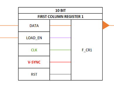

Step 4: First Column Register 1
The First Column Register 1 has a function to register the first pixel location with a light source in it, or when the value of the pixel is ‘1’. This is necessary to determine where an array of light sources starts. Later, the data will be used to find the center position of the array.
To achieve this, the output COUNT_COLLUMN become an input as DATA in the register. The input LOAD_EN comes from output COUNT_LIGHT_SIZE. The DATA is registered when LOAD_EN is equal to “1” as in unsigned value. The Column Counter and Light Size Counter work in sync with CLK. So, as it keeps counting the current pixel location, when the Light Size Counter detects a light source, the current location is simultaneously sent to the register. Therefore, the first pixel with a light source is obtained.
Other than that, the inputs are CLK, VSYNC, and RST (Asynchronous Reset). The CLK is necessary so the components could work in sync. The inputs are registered only when the CLK is in rising edge. The VSYNC is used to reset the registered value when the system already moved to next frame.
And then the output F_CR1 should be subtracted by one. This is caused by the delay when the light source is detected and counted at the counter. The figure at Step 1 will help you understand better. Then, the output is later used moved to another register as a final value. This will be explained in the next section.
Notes:
· When LOAD_EN = “1” then F_CR1 = DATA.
· If VSYNC (HIGH = 1) means new frame which is back to first row.
Here's the link for VHDL code : FIRST_COLUMN_REGISTER1.vhd

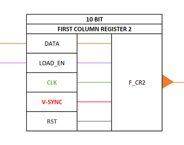

Step 5: First Column Register 2
So, why should there be another register for the position? This register works a little differently from the previous one. It takes the output from the First Column Register 1 as an input and register it when there is a wider array of light sources detected.
The output F_CR1 become an input as DATA in the register. The input LOAD_EN comes from comparator output BA at Max Light Size Register. The DATA is registered when LOAD_EN is equal to ‘1’ which means there is a wider array of light detected. The other inputs are CLK, VSYNC, and RST (Asynchronous Reset). Which works the same as the previous one.
The main goal of this register is to save the first position of a light source in the widest array of light sources in a frame. This could not be achieved by only using the previous register. Because it always registers the first position whenever there is a light source. So, there is no way of knowing if it is at the widest array or a shorter one.
Notes:
· When LOAD_EN = ‘1’ then F_CR2 = DATA.
Here's the link for VHDL code : FIRST_COLUMN_REGISTER2.vhd

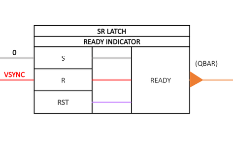

Step 9: Ready Indicator
Ready Indicator has the function to send signal when data is ready to be send to “Decide Direction and Speed” division. Ready Indicator is implementing the SR Latch system. The inputs for Ready Indicator are CLK which is for the system enable, R which is “Reset” on the SR Latch that has the role to indicates if data is ready to be send, S which is “Set” where the value is constantly ‘0’, and also RST (Asynchronous Reset) for the system. The outputs of Ready Indicator is READY which is the signal when data is ready to be send.
We design the circuit as follows (S = 0), the output (READY) can change only if the input R = 1 when the newly acquired data will be submitted to the “Decide Direction and Speed” division or if R = 0 the system will use the previously stored data memory. The figure below will help you understand better how SR Latch works.
Notes:
· The SR LATCH is known as set-reset latch, usually created by wiring two NOR GATES.
· In this system, there is internal signal Q to compare with the value of READY. In SR LATCH system, the value of Q and READY (QBAR) must be the opposites.
· The value of S will always be '0'.
Here's the link for VHDL code : READY_INDICATOR.vhd
