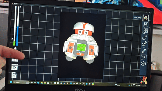

A two dimensional animated A.I assistant with his own personality running on a Windows tablet PC and mirrored onto a sheet of glass to give a 2D holographic effect housed in a thin yet sturdy display stand. The stand is completely black in colour so it is less visible in a dark environment making the holographic effect stand out more. The images of Vincent I drew/painted using Microsoft Paint 3D, then animated the images using Adobe Express, converted into GIFs, and then using a sound responsive program so when there is no sound, a GIF of Vincent subtly moves about in ‘Idle Mode’, then when he speaks a response to my query, a second animated Vincent GIF is displayed in ‘Talk Mode’.
For the assistant interaction I use my phone or an android tablet with either his own GPT personality or an A.I assistant installed, the phone is connected to a Bluetooth speaker fixed to the display frame, and the voice response comes through the speaker located directly next to the mic on the tablet to start the talking animation. The speaker/mic placement helps almost reduce false ‘Talk Mode’ triggers from ambient noise, and with the mic levels set to a certain position, every time there is a silent break between a spoken response, the ‘Idle Mode’ GIF will briefly display (think of a mouth opening and closing when someone speaks).

  6. Then finally connect my phone to the Bluetooth speaker, set up the sound responsive program, place the tablet onto the frame… then let the fun begin.

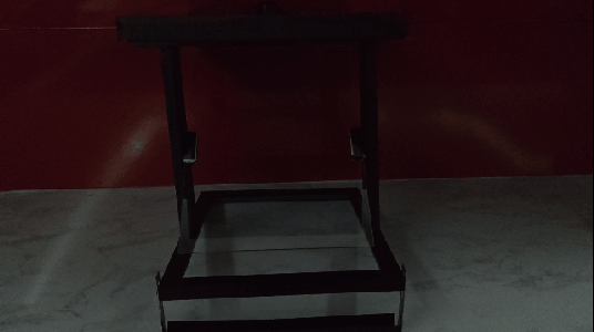

After tossing around a few ideas and making some sketches, I finally came up with a cheap, simple and a contemporary looking stand for Vincent to do his thing on. As I knew I was going to feature this on Instructables, I wanted the design to be easy to make using minimal tools and materials, and to be cost effective. So here is a breakdown of the overall stand design.
  1. I would use two A4 sized inexpensive picture frames using the outer frames for the base and to hold the tablet PC, the glass I could use as the transparent display, use one of the hardboard backing panels to rest the tablet on, and there would be no need to paint them as they were already coloured.
  2. I chose the colour black for the whole stand so it would be barely visible in a dark room and make the holographic effect be the only noticeable thing.
  3. The front of the bottom frame would be facing up as this was the nicer looking side.
  4. The front of the top frame would face down and house the tablet PC.
  5. One of the picture frames backing card would be used to support the tablet. The middle would be cut out for the tablet's screen to be visible on the glass.
  6. Two scrap pieces of 15mm MDF would make the side supports which would be fitted between the two frames.
  7. The glass panel would fit into holes drilled half way up the side panels with pivoting brackets to adjust the glass angle if needed.
  8. I front hinged foot rest would be fitted to the bottom frame to raise the front of the display up for better viewing angles if needed.
  9. I would make a removable Foamcore lid to cover the back of the tablet for astetic purposes and to house the Bluetooth speaker.
  10. Finally, I would do my best to draw Vincent using reference material found online, then animate them in two ways... GIFs for a talking avatar for A.I smart assistants, and MP4 videos to join together and make a video wallpaper to display to run in the background sitting on my desk or anywhere else I wanted to put Vincent. I actually started this project drawing Vincent first so that is how I organised the steps in this Instructable.

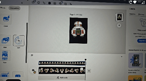

With our Vincent pictures made and ready to use, let's get the little fella moving. Adobe Express is the weapon of choice here as it has the basic animations needed for this project, and at the time of writing this, it's free. Another reason for using this was because not only did it have the animations I wanted, but one of the was a 360 degree spin which exactly what Vincent does in the movie so I was very pleased with that find. There is a paid for version that has more features and offers a free trial, but the free basic options are all that's needed.
  1. Open Adobe Express > click the blue ‘Go to Adobe Express’ button > ‘Start from your content’ > double click on your Vincent 'Idle' picture to upload it > Click ‘Edit original image’ > and then click on the ‘Background Colour’ icon (the plain square icon which should be set to default white) and choose black.
  2. Now click ‘Animation’ > ‘Loop’ > Scroll down to ‘Move’ > click ‘Bob’ > click ‘Bob’ again and move both sliders down to ‘1’ > test play it to see if you’re happy with it then press ‘Download’ (in the top right corner) > then click the blue ‘Download’ button below the formatting and resolution options. You can now open your downloads folder on your computer, then cut and paste it into your VINCENT folder and rename it ‘Idle Vid’.
  3. You can now follow the above section again to animate the ‘Talk’ picture using the same ‘Bob’ option and use the exact same ‘Speed’ and ‘Intensity’ slider settings so both the talk and idle give movement speeds match for smooth transitions between the two.
  4. You can finish of by adding other animations for the wallpaper/screensaver video.
The default timing (the length of the video) is set to 5 seconds thereabouts. This is perfectly long enough as this will loop perfectly for our needs in the next step, and for the video wallpaper we can add this as many times as needed in the video editor to run as long as we need. The small size will also help with quality when we convert the MP4 video into a GIF in the next step. So now we have our Vincent MP4 video folder filled, we can move to the next step.

  5. Now we can make our GIF. Open Ezgif > click ‘GIF Maker’ > ‘Choose files’ > select your Vincent all of your frames > click ‘Open’ > then ‘Upload files’ and wait for them to upload. Scroll down and click ‘Make a GIF’ > and when the GIF is done, click ‘Save’.
  6. Now scroll to the top of Ezgif and click ‘Video to GIF’ > just underneath that click ‘GIF to MP4’ > ‘Choose file’ > select the GIF we just made > click ‘Upload’ > ‘Convert GIF to MP4’ > Click ‘Save’. Now click ‘Reverse’ > ‘Reverse video’ > ‘Save’.
  7. Now you can rename the two videos, cut and paste them into your Vincent folder and add them into your video wallpaper using your video editor.
Top tips:
If you want to change the video speed of the head going up and down, you can do this in Ezgif under ‘Speed’ and change the ‘Multiplier’ value, or change it in your video editor.
I ended up with 24 frames and the motion ended up fairly smooth, but if you wanted to spend more time and make around 33 frames using a thinner 3 point curve tool in your paint program, you will end up with an even smoother motion.
Naming the Vincent frames 1 2 3 4 etc. (or A B C D) will help create the GIF as the GIF creator will organize them numerically and alphabetically. You can also delete the frames when you are finished making the GIF and MP4, but keep the last one with the head down as you can use that still picture as a pause in the video wallpaper between the 'head down' and 'head up' clips.
NOTE: If you don't notice any speed difference when the GIF is created, play it from your downloaded file instead of running it on Ezgif as there seemed to be a play back issue (at time of writing this), but the speed change did take effect in the 'Save' download.
Supporting files for the 'Head up' and 'Head down' MP4s are below, and the GIF versions are included in the pictures above.
Step 7: Making the Display Frame, Part 1:
With a picture frame I am using, laying down the sides of the picture frames are 15mm high and 20mm wide.
  1. Start by dismantling the picture frames, put the pieces to one side except for one glass panel and grab the pivot hinges.
  2. The next thing is to move your cat out of the way if they decide to join you just as your about to get stuck in to your project. (Fluffy four pawed assistants are optional, but not really recommended).
  3. Place the brackets with their foam glass protector inserts in place on to the glass making sure the pivot pin is about half way up the glass, and equal to each other. Tighten the screws only pinch tight so as not to crack the glass. Put to one side for now.
  4. Now grab one of the backing panels from the picture frames and remove any bits like wall hanger clips and fold out stands. Gentilly pry them off with a screwdriver.
  5. Measure the size of the tablet's actual display, mark out the measurements onto the panel so your cutout lines are centered, then use a sharp knife and metal ruler or cutting edge to repeatedly score the lines until it cuts through. Do all four cut lines and remove the center cutout (this is not needed).
  6. Test fit the cut out panel on top of the tablet to make sure all of the screen is visible (if the cutout is a little large, it's not an issue if the tablet bezel is black). Put to one side for now.
  7. Cut two pieces of 15mm MDF (5cm wide and 23cm tall), then vinyl wrap all four sides (not the top and bottoms), with black vinyl or paint with black paint (I wrapped mine with a wood grain effect vinyl I had left over from a previous project, but a small roll is very cheap).
  8. Measure and mark the center of both pieces, then drill a hole through both. The drill but needs to be a slightly smaller diameter than the glass hinge pivot pin so it is a tight push fit with a gentil tap of a hammer.
  9. Make a small pencil mark along both sides of the picture frames and do the same on both MDF pieces. Now add a small bit of glue to the bottom of one MDF piece, place it on your work surface facing up and hold it against the front edge of one of the picture frames which will be upside down .(use the other one for support). Then nail then together making sure the outside edges of the frame and MDF piece are flush and the pencil marks lined up.
  10. Now grab the glass with the hinges, place one pivot hinge into the fixed side panel firmly pushing it in. Now grab the the other side panel and attach it to the other hinge pivot. Gentilly tap the side panel with a hammer to firmly push both pivot pins in as far as they will go, but not so hard as to risk breaking the glass. Now glue and nail the side panel down the same the other one.
  11. Flip the stand over then glue and nail in the other picture frame, this time with the picture frames front facing down (as this will be the top of the display stand.
That is the main part of the stand done. The glass should be tight against the MDF side panels and have a stiff movement, enough for it to be moved and hold its position. Now you can switch the tablet on, transfer a Vincent still photo, a GIF or an MP4 onto the tablet, play the file and place the tablet into position. Put the lid on top, adjust the glass display angle, then stand back and check if everything is good (the darker the room, the better).
One thing to note for this testing, and for displaying the full assistant avatar gifs and video wallpaper is the orientation. The tablet obviously needs to be in portrait mode, but you need to lay the tablet down onto the stand with Vincent's head near the back of the stand (where the top part of the glass display is) or he will appear upside down. He might not mind, but you might.
Top tips:
Even though the side panels holding the glass are glued and nailed in place, the glass can still be removed if needed by loosening the pivot hinge screws, and sliding the glass out and in.
When cutting the two lengths of the MDF side panels, make sure that the ends are square. If they are not cut straight, when they are attached the top picture frame may not line up with the bottom one and look like it's leaning when looking at the stand from the front.
If you're using a nail gun, use a hammer to tap the nail heads flush if the don't drive all the way in.
While it was funny having my cat jump onto my work table and lay down JUST as I'm starting this project, please take caution with pets around where you may have sharp knife blades exposed or a hot glue gun switched on.

  3. To set up Veadotube, click on the top square /face icon for 'Mouth closed', then 'Replace image' and select your Vincent idle GIF. When it loads, click on the next square down for 'Mouth open' > 'Replace image' and choose the Vincent talk GIF. On the following two squares, click and choose 'Remove image'. Now click on the keyhole shaped icon under the pencil icon, then click the 'X' to delete the 'Wobble' motion. Now set the 'Microphone delay duration' slider to the very top, and the 'microphone volume cutoff' near to the top (test and adjust later if needed). By tapping your tablet you should see the GIFs movement both matched up and change to the talk GIF displayed.

To hide the grid lines and option tabs on Veadotube, on a PC or laptop, move the pointer off the screen. On a tablet, tap the very top of the screen or a blank space on the taskbar. Tap anywhere else on the screen to show it again.
In stage 6 above I mentioned about handling and placing the tablet onto the stand with Veadotube running so the orientation doesn't change. It should be in portrait mode then lay it down, but with the video wallpaper it's different. If you remember I mentioned in step 5 stage 5 that the video wallpaper clips had to be rotated 90 degrees during editing and saved. Now if you were to have the tablet in portrait mode, Vincent would shrink in size. So now place the tablet in landscape mode, play the video wallpaper which will show Vincent on his side, then lay the tablet down onto the stand in landscape mode so the screen doesn't reorientate.
