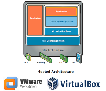

We will understand the step-by-step procedure to prepare to create a CentOS Virtual Machine (VM). We will make the best use of VMware Workstation (A Type II Hypervisor)
