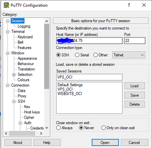

  1. Using your favorite SSH client software (I will be using PuTTY for Windows) enter the IP address and upload the proper authentication credentials (Private key file)

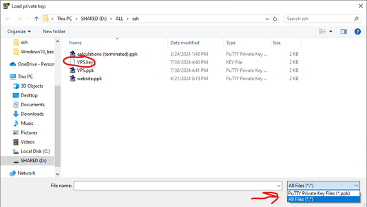

  2. If you are using PuTTY, you will need to use the built-in PuTTYgen software that comes with PuTTY during install. The .key file provided by OCI does not work by default in PuTTY. Using PuTTYgen, you can convert it.
  3. Open PuTTYgen and load the .key file provided by OCI during the server instance creation.
  4. Follow the pop-up when it appears.
  5. Click Save private key button to save it to your computer. This will now work in PuTTY.

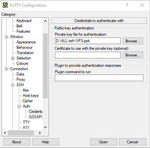

  6. Now, open (if not already opened) PuTTY software and load the private key. This can be done by navigating thru the tree menu in PuTTY to Connection > SSH >Auth > Credentials
  7. Once the file is loaded, be sure the correct IP address is saved (in the main session tab)
  8. Save the PuTTY config with a name if desired.

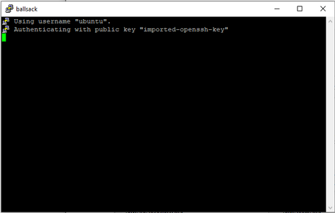

  9. Press Open to initialize the connection to the server...
  10. If a message appears warning you about how the key is not in the cache, ignore it and click Accept connection.

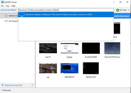

Now, open up a VNC viewer/ client on your local machine (I used RealVNC, a popular choice) and enter the Server's IP address in the top bar.
Hit enter, and the connection should be starting. If you see warnings about encryption, press Continue.
When prompted to enter your password, it is the same one you entered back in step 2. It is NOT the same one as your server password (unless you made them the same...)
