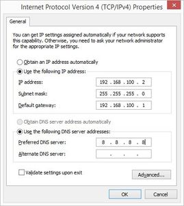

Step 3: ​Set the Static Address
1. Right click the option( or win +x), choose Network Connections.
2. Right click the Remote NDIS based Compatible Device, choose properties.
3. Double click Internet Protocol version 4 (TCP/IPv4).
4. General set options as follow:
