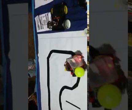

Introduction: VOICE CONTROLLED ARDUINO ROBOT
hello guys this is Milin here,
a technology enthusiast you can join on to my instagram page
there you might come across new projects and you might wanna build few of them
so today we will be building a voice activated bluetooth robot.
mainly the data tranfered is only the texts from mobile bluetooth the robot bluetooth module
so mainly using the software i have made the android application in MIT edu app inventor
that converts your voice signal to the text like forward baclward left right etc...
