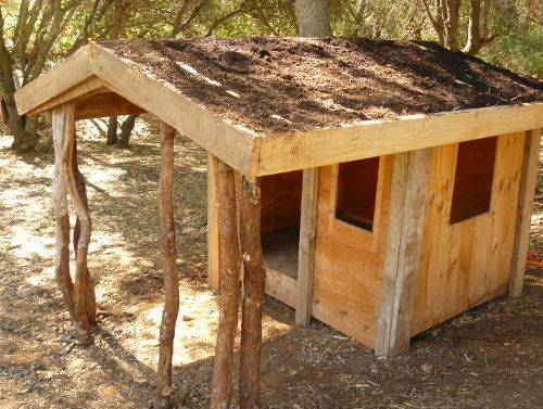

I wanted a simple phone-system running from my kids treehouse to a little playhouse in the back. I had some basic phones I found at thrift-stores. I read various instructables telling me how to add a small bit of voltage to the phones to make them operable; however, this method did not have a way of making the phones ring.
