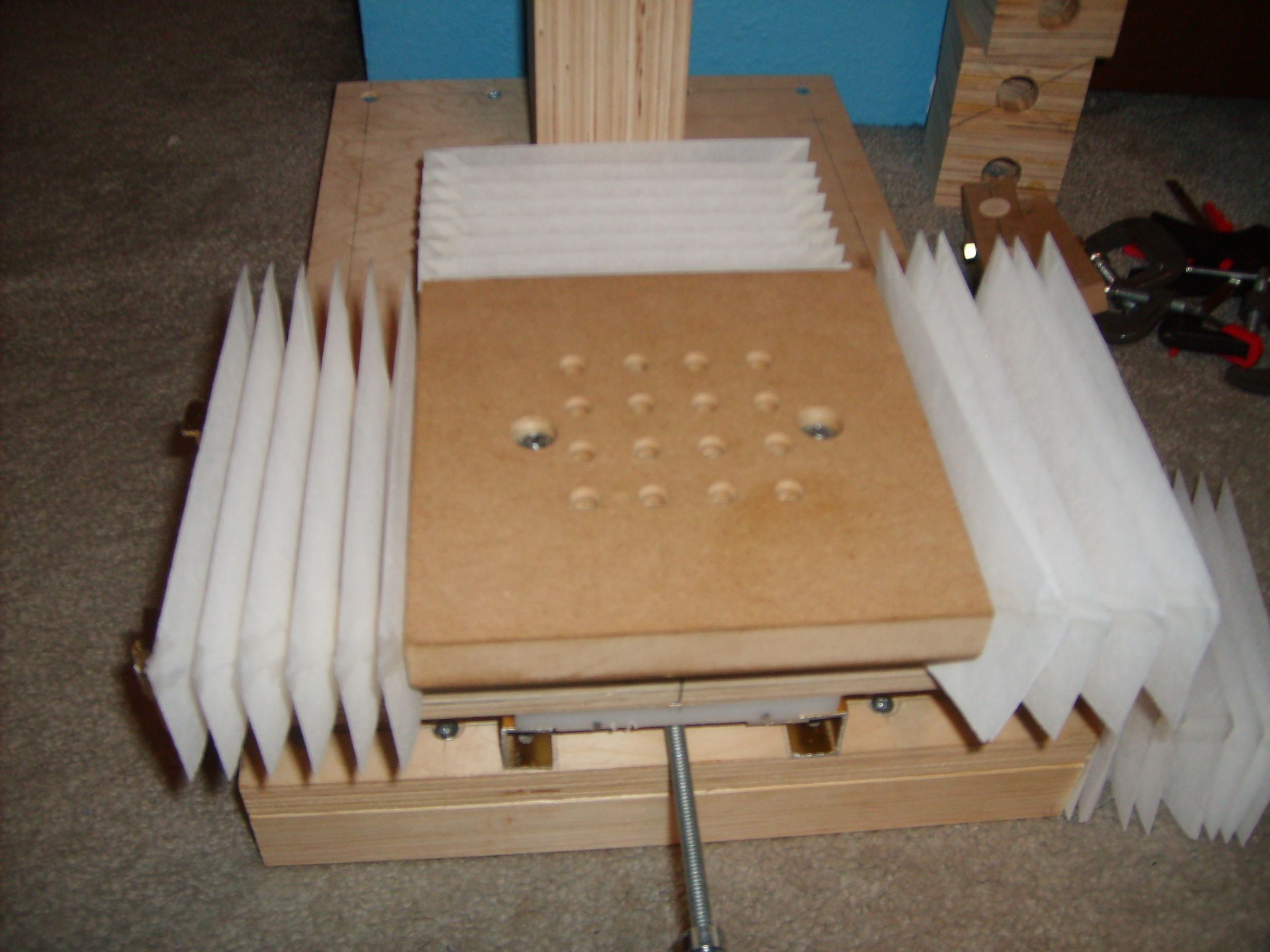

First, you want to plot out where you are going to drill the holes
I chose to have a 4 x4 of 1/4" holes in the center of the table. This will make it so that the vacuum works for small AND large pieces of material.
Using a 1/4" Drill bit, drill 1/8" down into the Mill Table
then, use a counter sink bit to clean it off and give it a professional look.
using a counter sink will ensure a smooth finish, cleaning off any burrs on the top of the mill.
Step 3: Drill the Pipes for the Suction to Effect
Now you need to drill holes from the side of your machine, to the furthest hole that is going through the top of the table.
Step 4: Tubing Assembly
First, get some of these plugs: 1st picture
Second, cut off the sharp points (i used wire cutters)
Third, attach tubing to the plugs
Fourth, attach all tubes to the Tube bay
Fifth, punch hole in the drain plug and stick the tube from the Tube Bay into the drain plug
EDIT: Make sure you turn the valve for the other tube connectors in the tube bay that aren't being used, to the closed position, or else your table wont have any suction.
Step 5: Putting It All Together
Now, just plug all the plugs into the side of the vacuum table and then set the drain plug at your vacuum's nozzle.
Step 6: Finished and Testing
Now, just turn on your vacuum and stick a piece of material on your mill and ur set!.
Since the tubes are fairly skinny, it will provide a strong suction because air that would be trying to go through a vacuum's big tube, is being forced to be pulled through tiny tubes.
No more clamps or supports or ANYTHING! :D
