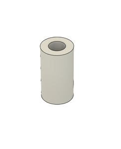

To support the mounting screws in the middle of the vacuum table and prevent damage to the MDF, I cut a PVC tube the same height as the ribs. I made 7 of these.

I cut slots for the ribs to sit within, and I also cut bores for the PVC spacers to sit within.
This helped with locating everything when glueing together and adds stability. We also need to drill mounting holes.
