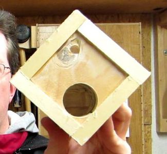

Step 1: The Base Frame
You need a square piece of stock for the base, and the simplest way to get that is to pick a scrap piece that is alread square (or at least square enough). Frankly, you could use a round, oval or pear-shaped piece for all I care, this little helper will work regardless.
But since it requires a border on one side made from the thin material, and since creating that as a square is the easiest way to get it done, I will go with a square here.
To create the frame from the thin stock, say, thin plywood, first cut a long strip about 1/4'' or 6 mm wide. Next cut pieces of the length of your baseplate minus one width of the thin stock. Confusing? I hope the pictures help to make it clearer. This way, you get four pieces of equal length that can be combines into a square frame for the base.
If you do not have any thin stock you can cut it from a larger board, but make sure that is is not much thicker than the aforementioned 1/4'' or 6 mm, because anything you add here will reduce the depth you will be able to drill to. That might not matter much for the holes you plan to drill, but you never know when that extra bit might come in handy.
Go ahead and glue them in place using wood glue and clamps.
Step 2: The Not Quite Black Hole
The vacuum needs to attach to the base plate (in a sense), and for that you need to drill a matching hole into it. I happen to have a forstner bit for the outer diameter of m shopvac hose. If you do not have that luxury, you might get away with a "close enough" in this step.
Because actually, this hole will not get to see the vacuum hose at all, so if this one is a little on the wider or smaller side, it will not matter. You will see why that is in the next step.
The main and most important idea here is to keep the hole inside the frame we already glued. The best way to do that (and also what I should have done) is to drill from the framed side so you know where the hole will be. Also, remember to put a backer board underneath the piece to prevent tearout when drilling through.
