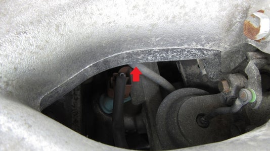

There are a number of vacuum hoses, electrical connectors and coolant lines to be removed, including a small green vacuum switch behind the intake that's held on by a bolt.
The front coolant line can be removed now, and the rear coolant line will be removed once the throttle body is unbolted.

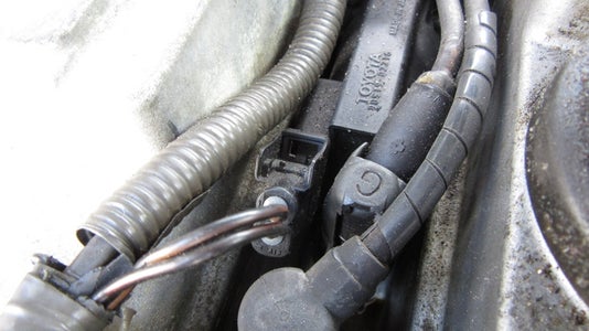

Step 4: Remove the Ignition Wires and Coils
Remove the ignition harness from the coils. Be-careful as they're brittle and will break and you'll need to replace them.

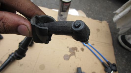

Remember those brittle coil pack connectors? Now's a good time to change them.
They can be found on eBay. You should buy 3 in case all three of them break. In this case only the front one disintegrated. A pin was used to de-pin them from their contacts and the new one slides right in.
