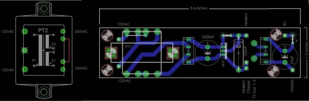

I will not be feeding this pedal 18VDC. I say pompously: that is not how valves work. They will accept that voltage with a smile and a barely perceptible cringe; but the fact is if you want to be feeding the air with valve-induced vibrations you will need to work with high voltage, as the low voltage does not allow the gear to work at its full potential.
This particular power supply will give you a regulated 12VDC for the heaters and unregulated 290VDC for the B+ supply. A larger resistor than the 1k 1W or a choke will get you a lower voltage--I felt that 290VDC is a good starting point.
The 12VDC regulator needs at least 13VDC at its input and you'll want to aim a little higher to guard against fluctuating wall supply. Conversely you do not want to introduce too high of a voltage as the regulator will convert the excess voltage largely into heat.
Remember that transformers transform voltage. They do not have a set input and output, only a set ratio of input to output. When a transformer says it has a 120VAC primary and a 10VAC secondary it's really saying that its two windings maintain a 12:1 ratio with each other. Thus 120VAC on the primary makes 10VAC on the secondary---and---10VAC on the secondary makes 120VAC on the primary--AND---3VAC on the secondary will make 36VAC on the primary.
The other conversion you need to start off understanding refers to power handling. If the same transformer as above has a 2 Amp rating then you can multiply 2 Amp with 10VAC to get 20VA. Now whatever voltage you get from a transformer you can divide the VA rating by the final voltage, regardless of which winding provides the final voltage. In the above examples, 120VAC would handle 0.16 amps or 160mA and 36VAC would handle 1.8 Amps.
The first transformer in line produces about 16.5VDC when rectified, which will keep the regulator happy. The first transformer also sends 12.6VAC to the next transformer, which is flipped so that the 12.6VAC goes into the secondary winding and becomes 216VAC at the primary winding, which rectified becomes about 300VDC. This is dropped to about 290VDC by the 1k resistor.

Here's a larger image of the schematic and PCB
One can build this on a breadboard, though I might suggest gluing two pieces front to front, then soldering all the connections you can reach on both sides, giving a better mechanical connection. The layout I'm including is positioned on a grid that matches a typical breadboard.
I used a nice, thick copper-clad board. For this, I drew the layout on graph paper, glued it to the PCB, and drilled through the paper guide. On the copper side of the board I drew the connections with a marker and used an exacto knife to cut gaps in the copper. I widened these gaps with a scratch awl, and there were my traces (Fig. 6a).
For that personal touch, I painted my board black and wrote in the values of the parts on the face.
Update:
The transformers I had listed are ones I had laying around and PT2 was right at its amperage limit-- you might want to use 546-186B120 for PT2. Its secondaries (lugs 5 and 8) would be attached directly to the IEC and power switch in parallel with T1, the primaries (lugs 1 and 4, with 2 and 3 soldered to each other) making about 330VDC rectified. The extra voltage will make the valves love you so hard.
This will take a bit of stress off both power transformers, decreasing heat and increasing lifespan. 546-186B120 is not PC mounted but you can shorten the Power PCB and mount T2 in the new space. Moving T2 off board and feeding it from mains is the only change. I have both versions of the PCB posted, but the new version is recommended.
