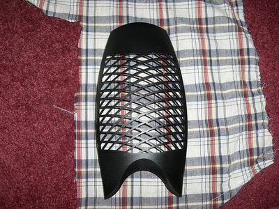

Step 4: Size Fabric
Now you'll need to cut the fabric to size. Be careful of pulling on any errant threads, as doing so could cause the fabric to pucker.
Make sure that you leave plenty of room around the edges, because in the upcoming steps you will need some room to grab onto, as well as enough fabric to cover the sides and a portion of the reverse side.

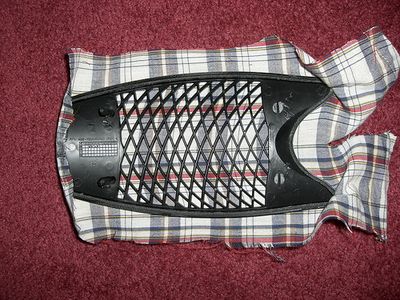

Step 5: Begin Wrapping
To start wrapping your panels, begin first at the top, and make sure it's lined up properly and the way you'd like. After this point, trying to remove the fabric could tear it.
**After you've applied the glue, be careful and DO NOT touch the glue with your hands. It will bond INSTANTLY, like the package says. The glue WILL seep through the fabric, I found this out the hard way**
Begin by applying the glue, then with the slant-tip tweezers (or pliers) pull the fabric up and over the portion with the glue. Then use the end of the other pair of tweezers and slide it along the point it's adhering to. Do this for a few seconds.
To be sure you have good adhesion, take the back of the tweezers or what you have at hand, and tap firmly. The tapping keeps the tweezers from sticking and pulling the fabric up with it.

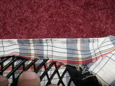

Step 6: Create Tension
You want the fabric to be taught on the surface of the panel in order to avoid wrinkles.
To create even tension (examples in the last frame of the results of both uneven and even tension) you can place a little pressure on the panel as you slide it a little across the carpet. Then rock it back onto the edge to hold it while you apply glue and adhere the fabric. Repeat the same process here as you would for the top.
