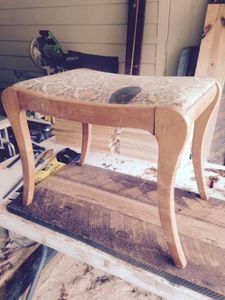

Step 1: Tear Down
First strip off all the old upholstery and any padding. This will all be replaced.

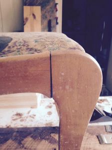

Next up I decided to completely disassemble the frame and re-glue due to some failing joints. You can see in the picture an example of the gaps.
