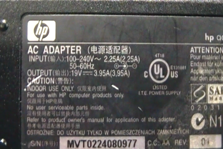

1. 19V laptop adapter to power module (used)

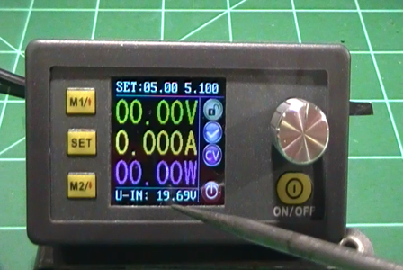

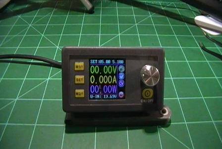

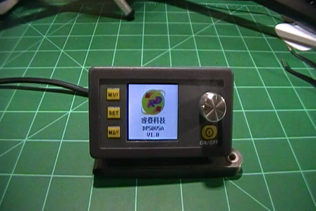

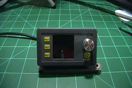

4. Stand-alone module (from gearbest.com)
5. Boot-up screen

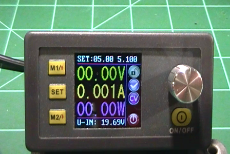

6. Stand-alone colored LCD module powered up

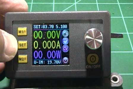

7. Input Voltage: U-IN: 19.69V

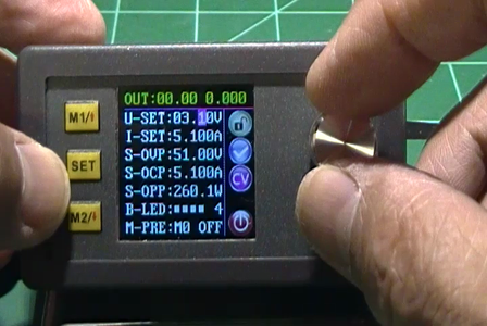

8. SET button - use selector knob to adjust voltage
9. Voltage SET ready to be fully power up

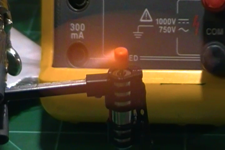

Step 2: Setting Up a 7mm Brushed DC Motor
If you would like to pick one of these up for yourself or as a gift, please use the word "Voltage" as the coupon when checking out.
1. Using SET button to set output voltage

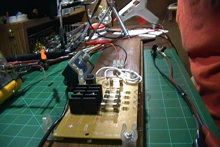

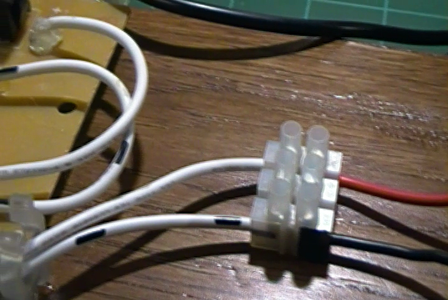

2. DC output +/- connections (taken from an old washing machine)

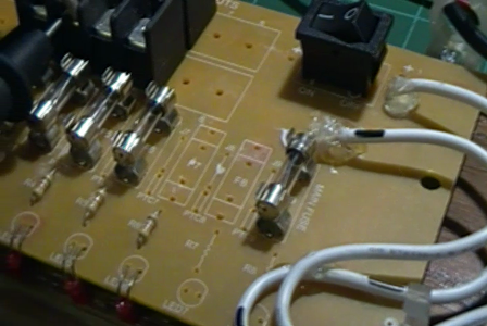

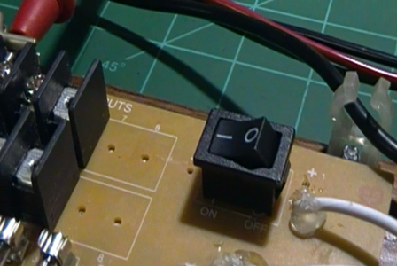

3. DIY board with connectors and fuses (found in dumspter)
4. In-lin ON-OFF switch (taken from an old washing machine)

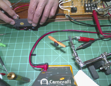

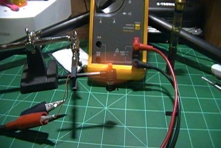

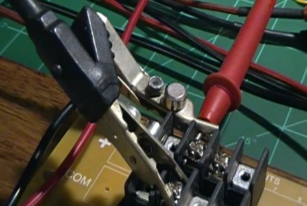

5. Connecting alligator clips and multimeter for the DC motor test

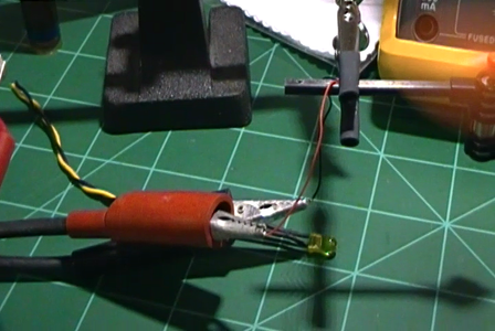

6. Connecting alligator clips to DC motor

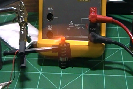

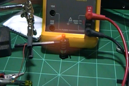

7. DC motor powered by DC module (taken from RC parts bin)

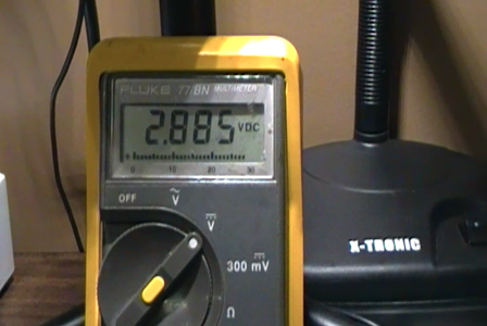

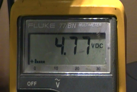

8. Multimeter voltage output #1 (Fluke 77/BN - oldie but goodie)
9. LCD readings from brushed DC motor
10. Increasing voltage (variable)
11. Motor spinning 1,2,3
12. Multimeter voltage output #2

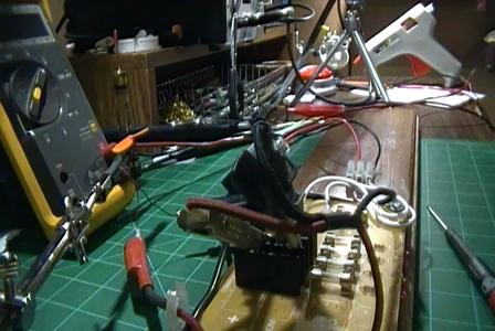

Step 3: Work Bench Views
1. Side view of work bench #1
2. Side view of work bench #2
3. Smart phone connect to OTG cable (home made)
4. WebCam connected to OTG cable
5. Side view of work bench #3
6. Work bench #1
7. Work bench #2
8. Overhead view #1
9. Work bench fully powered up with remote

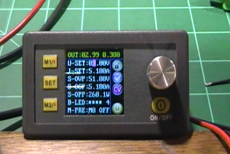

Step 4: Setting Up OVP - Over Voltage Protection

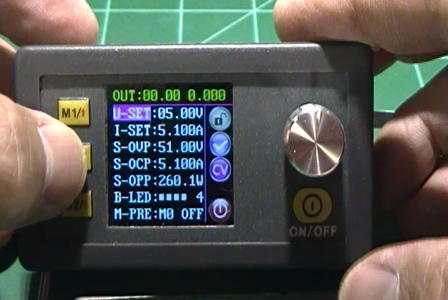

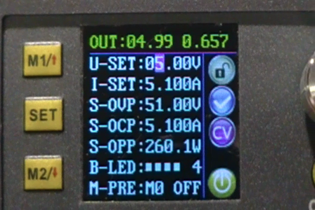

Panel Button and Descriptions: more detailed information in the supplied manual
• M1 Data group 1/ Page up to choose
• SET Data setting/ Extract value of the specified data group/ Store values into the specified data group
• M2 Data group 2/ Page down to choose
• 1.44 inch color LCD screen
• Selector knob/Data adjustments/Lock all buttons
• ON/OFF - closes or opens output
Photos:
1. SET button to adjust OVP - over voltage protection
2. OVP #1
3. OVP #2 SET
4. OVP SET to power 12V DC pc fan
5. 12V DC PC Fan #1
6. 12V DC PC Fan #2
7. Verify 12V

1. SET button to adjust OCP
2. OCP - over current protection
3. OCP SET to .950ADC fan running after applying power
4. OVP set to: 12V and OCP set to: .950A
5. Beginning to increase voltage/amps #1
6. Increasing voltage/amps #2
7. Increasing voltage/amps #3
8. Increasing voltage/amps #4
9. Voltage set to 13V OVP shuts down power to prevent damage
10. All functions disabled until powered on/off again
11. 12V DC pc fan - fully shutdown by OVP

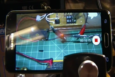

Step 7: Video Goes Wonkie on Android Phone S5
Possible #alienwii activity happening here.
1. Up close Video goes wonkie #1
2. Video goes wonkie #2
3. Video goes wonkie #3
4. Video goes wonkie #4
5. Video goes wonkie #5
6. Video goes wonkie #6
7. Video goes wonkie #7
8. Video goes wonkie #8
9. Video goes wonkie #9
