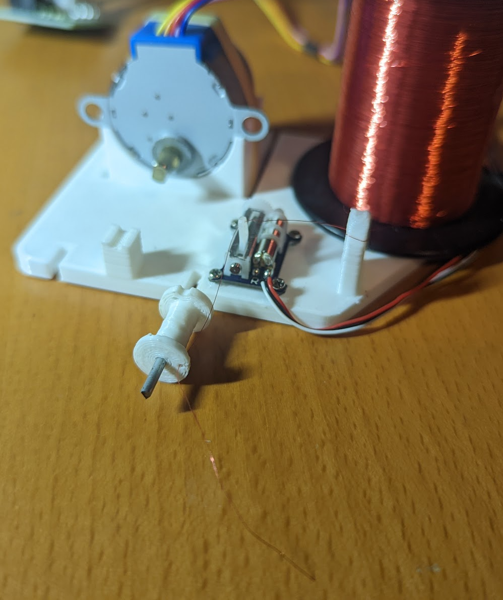

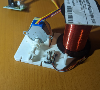

Step 2: Assembly
Mount the linear actuator using the 4 screws, and make sure the cables lead towards the closest side of the print. Next seat the stepper motor into its support, then secure it using a rubber band.

Step 4: : Load a Core and Start the Program
With the Arduino unplugged, put the roll of magnet wire onto the post. Feed the wire from the spool, loop it through the tensioning hole and the linear actuator, and finally feed it through the core as shown below leaving a couple of cm of lead. Place the connector on the shaft of the stepper motor, load the nail into the core and align it with the connector, the elastic band should make this process easier because you can tilt the stepper motor up as needed. Secure the core into place using the cover and another rubber band.

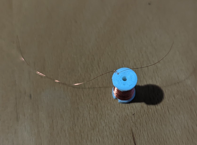

Step 5: Run the Program and Prep the Finished Coil
Once the core is mounted plug the Arduino in and the program should begin to run. Note that these stepper motors are not fast, and a big coil can take up to 3 hours to wind. The program will stop once complete so leave it winding somewhere it can be checked on occasionally. The first lead that was left sticking out in step 4 will likely wrap around the nail, this is ok if it doesn’t knock the core off the stand. Once the program is complete put a drop of superglue on the coil to prevent unwinding. Pull the coil out and clip the wire off, this wire can now be glued into place in the groove beside the hole in the core the first wire was fed through. Sand the insulation off the leads and your electromagnet is now good to go.
