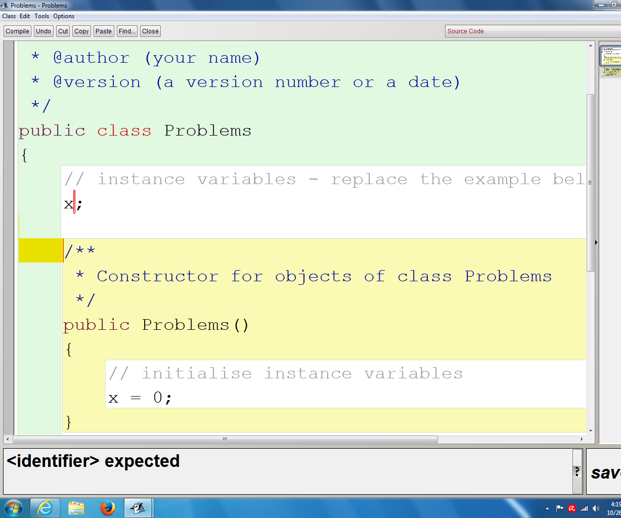

As seen on the example provided above, the "equation" in the method "x = 5 , return x" Let's the program to know that "x" equals 5, but what is actually happening?
When we type : "x = 5" The "=" sign in Blue J doesn't just mean equals. The "=" sign in Blue J means that a Variable is getting The Value of an expression. (" x = 5 " is also known as "variable(x) = expression (5)" ).
Notice on the top: "private INT x;"- That means " x " is a whole number ( if we want to be 5.0, than we need to change the integer ("int") to a double ("double").
