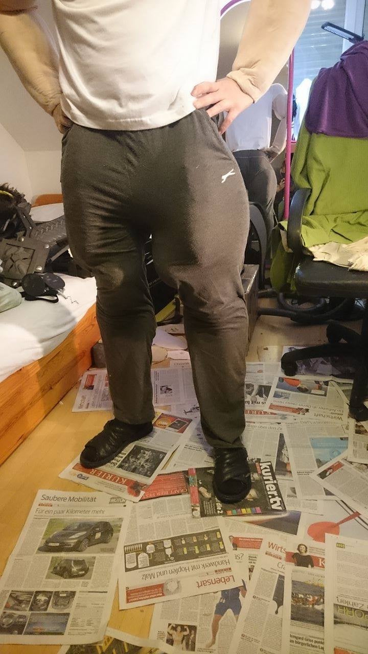

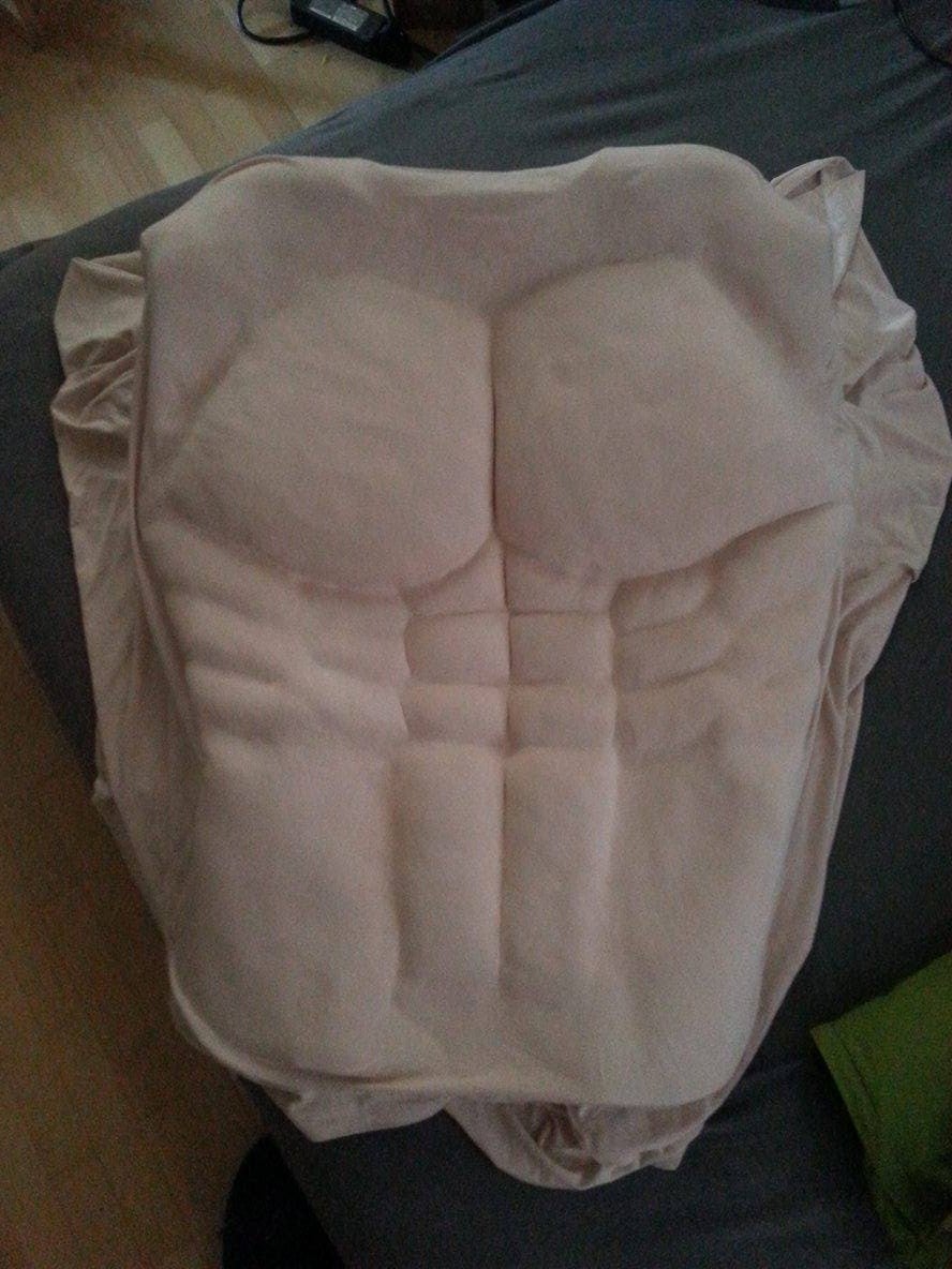

Step 3: Muscle Suit
Noone likes muscular characters being cosplayed by skinny guys. Since i cant gain about 100 pounds of muscle, i had to make my own.
Muscles were carved out of Matress foam, and then coated with spandex

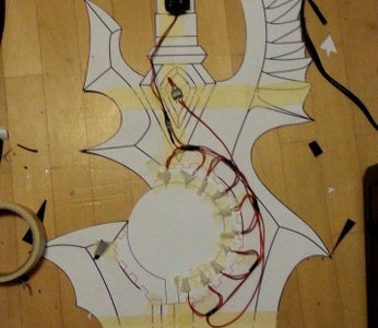

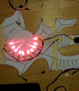

Step 7: Sword Building
patterned the sword in Illustrator, cut it into segments and fed it to the lasercutter. The center piece was cut out of acrylic and engraved with a fireball, also slots for the leds were cut out.
The center piece is actually 2 sheets of acrylic of 2mm, so i could airbrush the inside of the pattern in Fireball colors, so the paint cant rub off and the outside is shiny.
I then glued the pieces back together, soldered in red leds, and added a chipset so the sword would pulsate. Once everything is glued together i put Insulation foam on the sword and carved in the details.

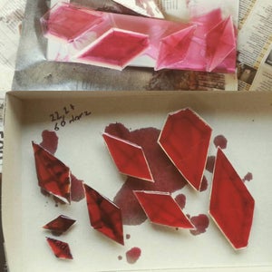

I also cast all the gems for the sword and Armor in Polyurethane Resin with a red tint and wrapped the handle with a leather braid.
