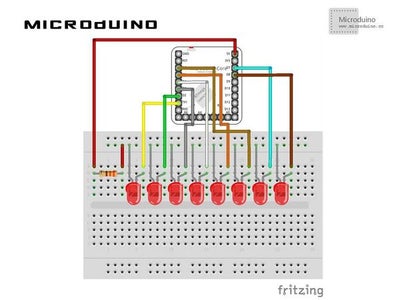

Step 2: Schematic
Program
https://github.com/Microduino/Microduino_Tutorials/tree/master/Microduino_Processing/sketch_8LEDs Note:Don't drop the picture in program
Step 3: Debug
Step 1:Set up hardware system, as picture showed
