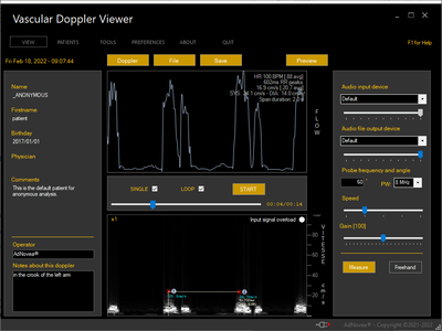

Spectrum analysis of the audio signal can deliver additional data such as the blood speed and the variation of the blood flow during systolic and diastolic periods. The Vascular Doppler Viewer application is aimed to display these additional data.

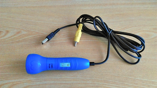

If the easiest way is to buy a Fetal Doppler with the 8-MHz probe (~30$), the cheapest one (~10$) is to get a replacement probe only and to change the sockets in order to connect the computer's USB (+5V power supply) and audio inputs.

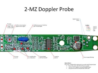

IMPORTANT : BEFORE ordering the probe only, you must be sure that the probe embedded all the electronics and delivers the audio signal corresponding to the frequency shift.
On the photo above, we have modified a 2-MHz Doppler probe from VCOMIN. The modified probe can be directly connected to the PC without further interface. Nevertheless, we remind you that a 2-MHz probe is dedicated for deep Doppler and is not well suited for general vascular monitoring uses. Moreover, a deep Doppler induces more interference from surrounding vessels.
NOTE : For the audio connector, connect only the probe output that delivers the signal and the common GND.

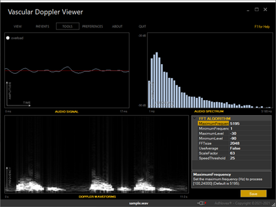

Basically the Vascular Doppler Viewer application makes a spectrum analysis of the Doppler audio signal.
  1. The first step is to "calibrate" the Audio Signal for avoiding artifacts.
  2. There is a tab named TOOLS that provides 3 screens :
  3. The first one is a Signal Scope. You have to adjust the signal using preferably the Doppler device Volume or in case of Doppler probe only, the Audio Input slider. You must absolutely avoid signal overloads.
  4. Next step consist of calibrating the Audio Spectrum to get rid of the noise and to maximize the amplitude without clipping.
  5. Last step is to choose the frequency range and Scale Factor to adapt the Doppler Waveform to your needs.

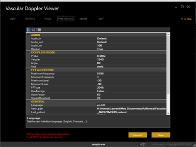

They are several parameters you can tune. These are available from the PREFERENCES tab with a short description for each.
Finally there are also some additional features such a printing, audio file saving or patient's database management (common to all our software).
Due to the strong impact of insonation angle, hardware performance, etc. the accuracy of the measure cannot be guarantee. This application gives a visual information in addition to the audio information.
