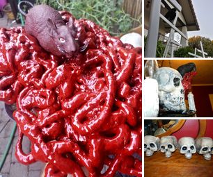

Step 5: Finished Skulls
Here's what I was able to do using these methods.
Halloween has become very expensive, especially for those who are and are trying to build a prop collection or put on a haunted house. Don't pay the outrageous prices you find in places like the spirit halloween store.
Since I already had all the materials needed apart from the skulls, the only costs involved were the $1 skulls. That's decorating on a budget!
