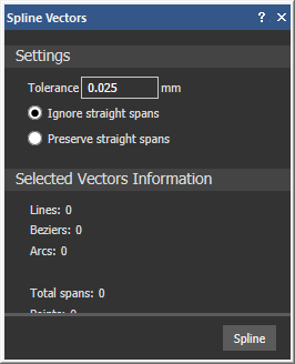

Spline Vectors - Smooth selected vectors by fitting curves and reducing nodes

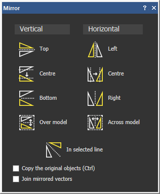

Mirror Vectors - Mirror selected vectors

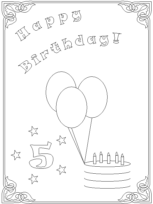

Vector creation will be introduced with the design of a simple Birthday Card for engraving purposes. Functionality demonstrated will include the Vector creation tools, Text on curve, Node Editing, Block Copy/Rotate, Transform Vectors, Paste along Curve and Importing of Vectors.

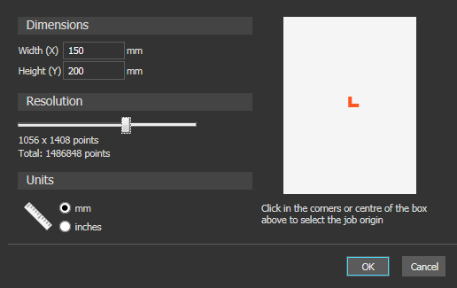

1Open New Model.
2Enter a Height 200mm(8"), with a Width 150mm(6").
  • Set the Origin to the center of the model and a resolution of approximately 1056x1408 points (by moving the slider).
A new ArtCAM Model (sheet) is generated based on the parameters defined above.

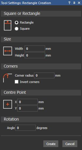

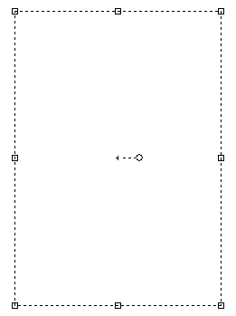

1Using a method outlined above, open Create Rectangle.
The Rectangle Creation form appears in the Tool settings panel.
2Enter a Width 130mm(5"), a Height 185mm(7.25"), Corner Radii 0mm and a Centre Point X 0 and Y 0.
3To create the shape and close the function, single right mouse click in the main window.
The rectangle is created on the model page and the Create Rectangle function is closed.
To create the shape whilst keeping the rectangular creation form open, single left mouse click in the main window. This can be utilised to create additional rectangular shapes.

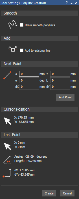

1Open Create Polyline.
Polylines can be generated by entering absolute co-ordinates in the X and Y area, by angles and line length and as relative co-ordinates using the dx and dy (distance from last point) or by clicking with the cursor.
Polylines can also be created dynamically in the graphics area either by holding down the left mouse key for freehand sketching, single left mouse clicks to create straight lines.

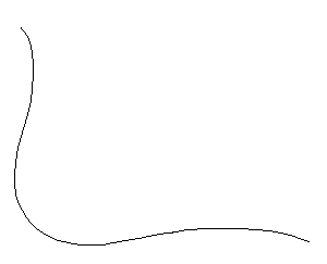

Sketching smooth curves will be illustrated below.
2Check the option Draw smooth polylines.
3Left mouse click 4 suitably positionedpoints to generate a Smooth Polyline as shown.
4Repeat to create a second polyline as shown.
Pressing the Space bar on the keyboard will complete the first polyline but keep the form open to start a new one.

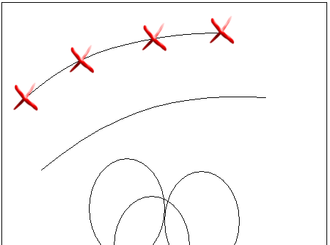

8 Select the top Polyline you have created and under the On a Curve section in the Text Tool click Select Curve
9 Type the word Happy.
10 Select Create on the text form to create the text and close the form.
11Repeat the above to create the word Birthday!On the second Polyline
12Click Create
13Delete the original two curved polyline vectors to leave the following result.

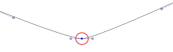

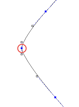

4With the ellipse vector highlighted, Open Node Editing.
Node Editing is a powerful tool which allows the structure and appearance of a vector to be changed easily. Node Editing will be shown in greater detail later on.

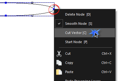

The ellipse shape will be split into two halves. This can be achieved in Node Editing by cutting the vector at the end node points.
5Move the mouse cursor directly over the right hand blue node.
6Right mouse click and select Cut vector from the local menu.
The node itself changes colour from blue to black.
7Repeat the above to Cut the left hand blue node
8Exit Node Editing by selecting Esc or N on the keyboard.

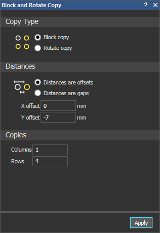

9With only the Lower Ellipseselected, click on the Block and Rotate Copy from the Fill ToolsToolbar.
The Block and Rotate Copy allows you to create a block copy in X and Y or a rotated copy around a point.
The distances can be set as centre offset value or by a gap value between each item.
10Open Block Copy and choose Distances are offsets options.
11Select an X Offset 0mm, and a Y Offset -7mm(-0.275�)
12Number of Columns as 1and, with Number of Rows as 4.
13Select Apply and close the panel using the X in the top right corner.

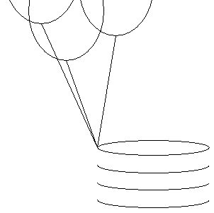

The lower vector has been copied into 4 rows to create the birthday cake.

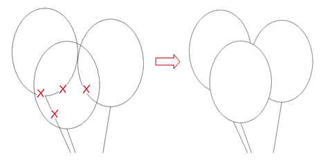

14Snap a single polyline from the bottom of each balloon ellipse to the left hand corner of the cake ellipse as shown below.

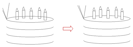

15Open Trim Vectors from the Vector Creation Toolbar.
16The internal vectors representing the balloons will be removed using this tool.
  • Select the inner ellipse and polyline vectors to trim as indicated.

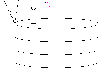

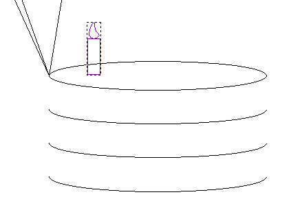

17Create a Rectangle with a Width 10mm(0.375"), Height 30mm(1.2"), Corner Radius 0mm and a Centre Point X -50(-2") and Y -50(-2").
18Create a Circle with a Centre Point X -50 (-2"), Y -31 (-1.25") and a radius 4mm (0.15").

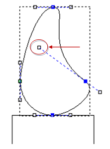

19With the new circle selected, enter Node Editing
20Use the cursor to select and dynamically drag the top node upwards as shown.
21Drag the upper control point (white squares) of the right hand node inwards to create a flame effect.
22Exit Node Editing.

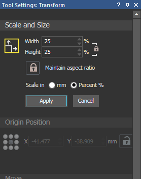

23Select the rectangle and 'flame' vector and then open Transform (or hit T on the keyboard).
24Change Scale to percent % and ensure both width and height are linked.
25Change the Scale to 25% and then press Apply.
Both vectors are relatively scaled down to a realistic size, and will now be moved into position.
26With both vectors selected, dynamically drag the vectors onto the cake as shown.
Multiple copies of vectors can quickly be achieved by using/holding the CTRL key.
27Ensure both candle vectors are still selected.
28With the Ctrl key pressed, use the left mouse to select and drag a new copy of the candle to a suitable position on the cake.
29Repeat three more times to produce a total of 5 candles.
30Use Trim Vectors to remove the small ellipse vectors passing through the candles.

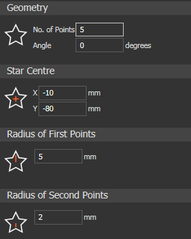

7Create a Star vector with the following settings. No of points 5, star centre at X -10(-0.375"), Y -80(-3.15"), Radius of first points as 5mm(0.2") and second points as 2mm(0.075"). Click Create and Cancel

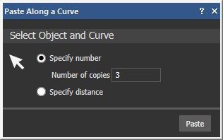

9From the Fill Tools toolbar, open Paste along Curve.
The vector is pasted incrementally along the curve either by dividing the curve equally (Specify Number), or by a fixed distance, leaving any surplus at the end of the curve (Specify Distance).
10Select Specify Number and enter Number of Copies as 5.
11Select Paste.

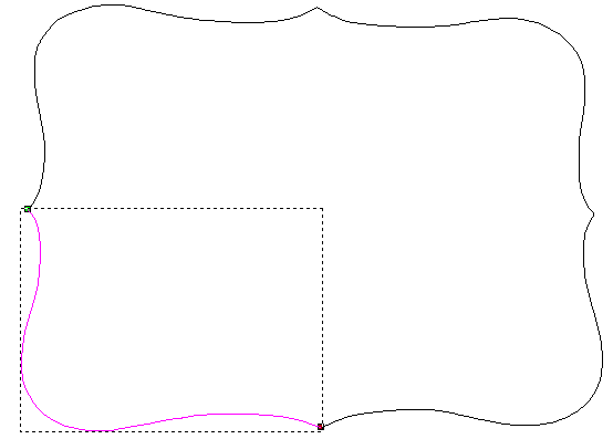

The card will be completed with an imported border feature.
13Select and delete the large original border rectangle.

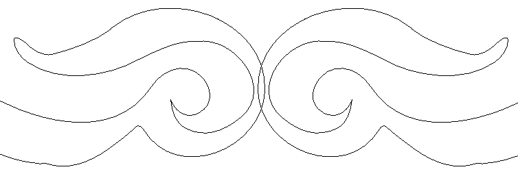

Vectors can be imported by using either the vector layers toolbar (to be discussed later) or from the main pull down menu.
14From the pull down menu, select Vectors and then Import.
15Browse to and open border feature.eps.
16(The design is imported into the current model and completes the design).
17Select File > Save As and enter the name Birthday Card and then Save.

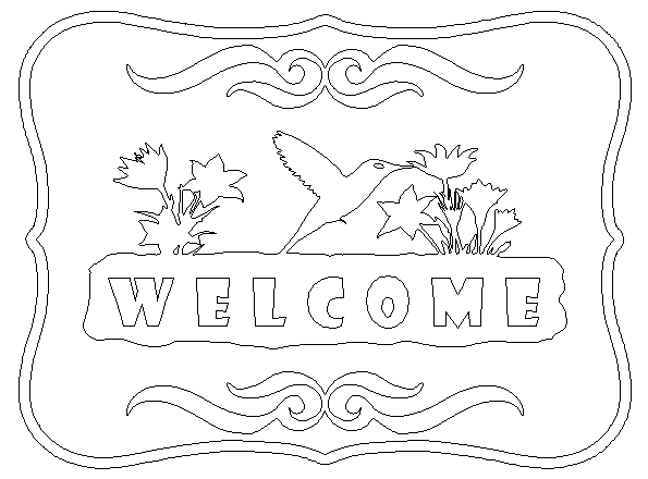

The second tutorial demonstrates further functionality to create a Welcome Sign/Plaque as shown below. Additional tools shown include Offset Vectors, Weld Vectors and Mirror Vectors.
The main design features are generated using Imported Bitmaps. Reducing colours of an imported Bitmap and the powerful Bitmap to Vector will be utilized extensively.

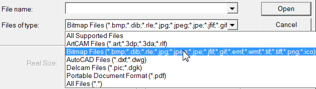

1 Select Open to open an existing model.
2 Change Files of type: to Bitmap Files.
3 Open the file plaque base.jpeg.

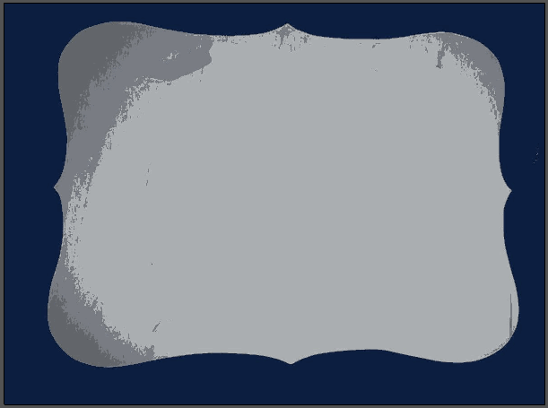

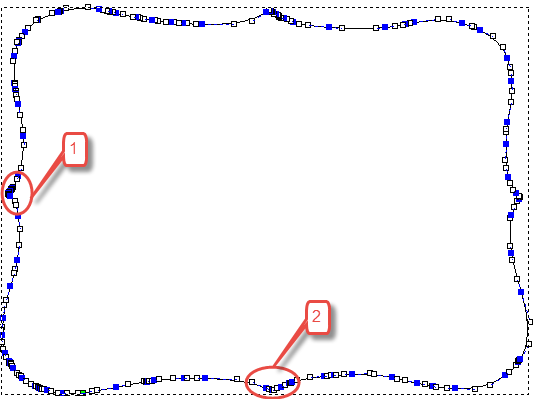

The Bitmap To Vector feature calculates the vector boundary of the selected primary colour in the bitmap image. This will be utilized to generate the outside boundary of the plaque border.
Bitmap or image colours can be reduced using the stand alone function Reduce Colors or directly within the Bitmap To Vector function.
6Open Bitmap to Vector.
7Click on the Reduce Colors button.
This form allows the number of colors in the Bitmap to be reduced by entering the required number or moving the slider bar.
8 Change the Number of colours to 3 before selecting Apply.
The colour palette now shows the only three colours that represent the Bitmap.

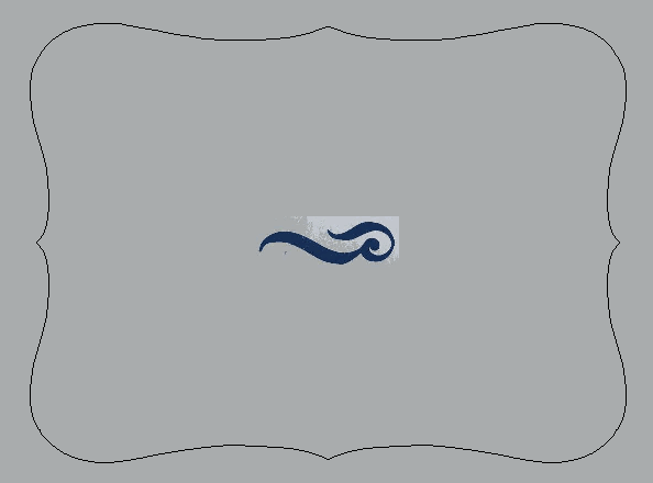

9Click on the dark blue colour directly from the palette to assign it as the primary color.
10 With the default settings shown above, Select Create Vectors then close the panel.
A vector has been generated on the boundary of the selected primary color. The Bitmap is not required so will be hidden.

1 Delete the outer rectangle vector and small cluster of vectors indicated.
The original Bitmap of the Plaque border is not symmetrical, so the above vectors will be modified to 'improve' the final design.

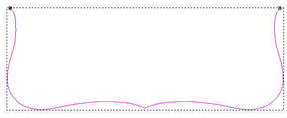

2 With the border vector selected, enter Node Editing.
3 Zoom into the area indicated with the number 1
4 Right mouse click over the left corner node and select Cut Vector.
5 Zoom into the area indicated as 2, and Cut the lowest corner node as shown below.
6 Pres Esc to exit node editing.
The lower left section of the initial plaque vector has been seperated at the node cut points.
7 Select and delete the large vector to leave only the bottom left vector.
The plaque vector will be recreated symetrically using this vector.
8 Highlight the remaining vector and open Mirror Vectors from the Vector Editing toolbar.
9 Ensure Copy the Original Vectors is checked, as well as Join mirrored vectors before selecting Right (Do not close the form).
The vector has been mirrored to its right hand side.
10 Select Top to mirror this new vector upwards.
11 Close the Mirror Vectors panel.
12 With the vector still selected,Select Center in Page or F9 on the keyboard.

1 Select to highlight Bitmaps in the Project Tree, then Import Image from the associated lower panel.
2 Select file scroll single.jpeg and open.
The bitmap is loaded into the current model and listed in the Bitmaps Project tree.
3 Right click on Vector Layers in the Project Tree and select New
4 Right click the new Vector Layer 1 and choose Rename. Call this new layer scroll.
Scroll is the current active vector layer, any vectors created will be drawn on the Scroll layer.
The bold layer is the active layer
Next the colors will be reduced and traced.
5 Open Bitmap to Vector.
6 Click on the Reduce Colors button.
7 Change the Number of colours to 2 before selecting Apply.
8 Click on the dark blue color directly from the palette to assign it as the primary color.
9 Select Create Vectors and close the panel.
10 Hide the Bitmap Layers by clicking on the light bulb in the Project Tree.
11 Select the new scroll vector and then Open Transform Vectors.
12 Increase the scale to 150% and then Apply.

13 Highlight the scroll vector and then Open Spline Vectors (listed with the Arc Fit tool).
The Vectors information area summarizes the number of spans that represent the selected vector. Currently, the scroll vector is made up of 44 Bezier curves, 2 lines and 134 points.
By adjusting the tolerance, the spans will recalculate to produce the shape based on this new fitting tolerance. In this instance, the tolerance will be increased to smooth out the overall shape.
14 Enter a Tolerance 1 (0.05") and press Spline.
Total number of span has been reduced to 26 and points to 78. (slightly different if using imperial units). This also makes it easier to edit the shape in Node editing as the number of nodes are reduced.
15 With the same tolerance, select Spline again. The shape will improve slightly further as the points are redistributed.
16 Close the panel.

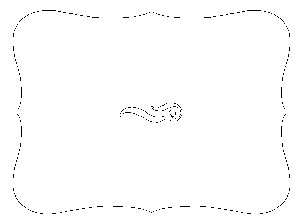

17 With this vector highlighted, Open Mirror vectors.
18 Ensure Copy the Original Vectors is checked, before selecting Right.
19 Close the panel.
The two vectors will be combined to create a single design.
20 Select the right hand side (mirrored) vector only and use the arrow key on your keyboard to nudge it left until they slightly overlap.
21 With both vectors selected,open Weld Vectors .
The overlap is removed to create a single closed vector. It will now be moved to a suitable position.
22 With the scroll selected press F9 to center it.
23 Hold the Alt key and drag it down towards the bottom as shown.
The Alt key will hold the vector straight while moving it.
24 Select the scroll vector and open Mirror Vectors from the Vector editing toolbar.
25 Select Over Model.
Welcome Plaque Design
1 From the Bitmap Layers in the Project Tree, Import the welcome bird.jpeg.
2 Click on the New Vector Layers plus sign in the Project Tree next to Vectors to create a new Layer
3 Do a slow double click on the new Vector Layer and Rename it to design
4 Open Bitmap to Vector.
5 Click on the Reduce Colors button.
6 Change the Number of colours to 2 before selecting Apply.
7 Click on the black from the palette to assign it as the primary color.
8 Select Create Vectors and close the panel.
9 Hide the Bitmap Layers by clicking on the light bulb in the Project Tree.

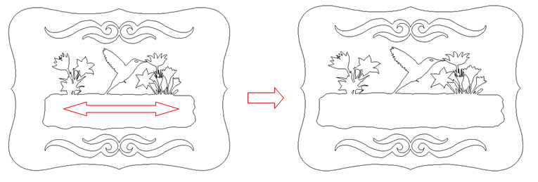

10 Select the vectorsas shown above open Transform Vectors.
11 Increase the scale to 120% and press Apply (Do not close the form).
12 The vectors have scaled relatively in both the X and Y direction. A scaling will be applied again but this time in the X direction only. This will result in the vectors 'stretching' to fill the available space better.
13 Unlock the option Maintain aspect ratio in the Scale and Size part of the form.
14 Change the scale to mm and increase the New Width to 900 mm (35.5").
The Vectors have rescaled but in the X axis (horizontally) only.
15 Click on the New Vector Layers plus sign in the Project Tree next to Vectors to create a new Layer
16 Do a slow double click on the new Vector Layer and Rename it to text
17 Open Create Vector Text.
18 Change to Font Showcard Gothic, Script Western, Size 90mm(3.5") and Character Spacing of 160%.
19 Type WELCOME
20 Drag to position the text block as shown.
21 Activate the borderVector Layer by clicking on it
22 Select the outer main border vector and then Offset Vectors from the Vector Creation toolbar.
23 Offset a distance 20mm (0.75") Outwards with Sharp corners.
The design is complete!
