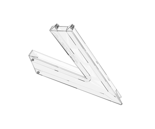

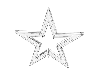

The five tips
The star is made of five identical tips which fit together by a male-female joint. The joint is secured with short segments of 1,75 mm plastic filament. The same kind as used by commonly available 3D printers. No glue or screws are necessary to assemble this star.

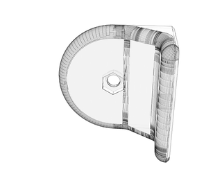

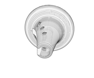

Cable mount for wall or ceiling
We also supply mounting brackets for hanging the star from a horizontal surface (ceiling) or a vertical surface (wall). The cone-shaped part which guides the cable can be rotated so that perfect parallell orientation of the star to the wall can be easily achieved.
Just let the star hang from it's cable for some time until it finds it resting orientation. Then just twist the cable holder gently until it is parallelle to your wall or window.

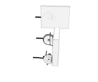

Cable wall mount (assembly).stl
This 3D file shows how the cable mount looks like in both horizontal and vertical postion.
Cable wall mount (horizontal).stl
The STL file for 3D-printing the horizontal cable mount.
Cable wall mount (vertical).stl
The STL-file for 3D-printing the vertical cable mount.

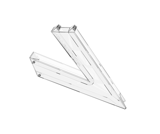

Vega - The LED-lit Christmas Star (assembly - Joint).stl
This 3D-file shows how two tips are joined with segments of filament

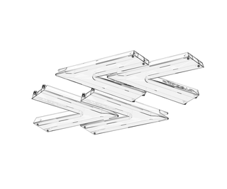

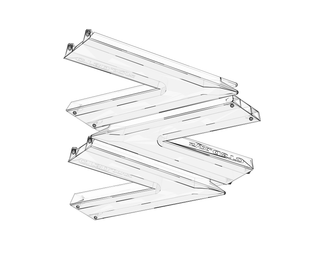

Vega - The LED-lit Christmas Star (Build plate - Polar - 10pcs).stl
Use this STL file if you have a large 3D printer with a build plate of 320 x 320 mm or larger. The file contains 10 separate star tips.
Vega - The LED-lit Christmas Star (Build plate - Replicator 2 - 4pcs).stl
Use this STL file if you have a 3D printer with a build plate of 285 x 150 mm or larger. The file contains 4 separate star tips.
Vega - The LED-lit Christmas Star (Build plate - RepRap.s 200x200mm - 3pcs).stl
Use this STL file if you have a 3D printer with a build plate of 200 x 200 mm or larger. The file contains 3 separate star tips.

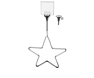

Vega - The LED-lit Christmas Star (complete assembly).stl
This file shows how the complete Christmas star is assembled - including LED strip, cable and mount.
Vega - The LED-lit Christmas Star (Electric assembly).stl
This file shows how the LED strip is assembled inside the star as well as the electrical cord from which the star hangs.

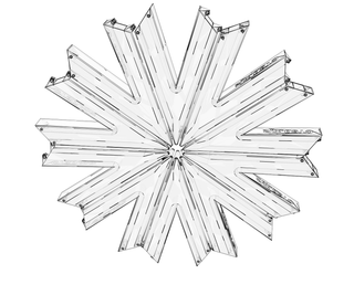

Vega - The LED-lit Christmas Star (printed parts assembly).stl
This file shows how the complete 3D-printed Christmas star is assembled.

Step 7: Attach the Cable Mount
The cable mount parts allow for vertical and horizontal hanging of the Christmas star.
Horizontal mount
- Use a small screw (aprox. 3 mm in diameter) to attach the cone-shaped part to a flat surface, such as a ceiling.
- Tighten the screw enough to allow friction but also let you freely rotate the cone. This will help you to adjust the star's orientation and make it parallel to a wall or window.
Vertical mount
- Use an M3 screw and nut to attach the cone-shaped part to the angled bracket.
- Use a small screw (aprox. 3 mm in diameter) to attach the bracket to a vertical surface, such as a wall.
