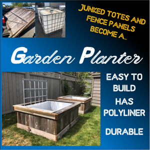

It is springtime, and everyone is looking for cheap and awesome yard and garden projects again. And you can't get much cheaper than this set of planters. Other than the fasteners (screws and staples) they are all made completely out of discarded and subsequently recycled items. Primarily, IBC totes, and old fencing panels.
The three of these were a one-day project if you have access to the tools I was using. It might be two days if you don’t have access to the pneumatic stapler and mitre-saw. But don’t forget, you can rent these at most rental outlets, or even the ‘Big-box’ stores like Home Depot. With how cheap the rest of this project is, that rental is well worth the time. Rather than spending money on an infrequently used tool, I have often rented tools.

I decided I wanted to make the planters just taller than the second ring. Then they would be about 14” deep as planters then. This meant I needed to cut the rest of the steel off. I used a cordless angle-grinder with a cutoff wheel.
One of the cages I trimmed all the way down, but two of them I left the back as a trellis for growing climbing vegetables.
Cutoff discs are a way faster method than a hacksaw or reciprocating saw. But you do need to be careful with them. Use your common sense, safety gear, and glasses, and lift the cage with your other hand as you pass through so they don’t bind down and shatter the discs.
Step 5: Cut the Totes Down Into Tubs
I used a marker to trace a line following the top ring I had left. Then I pulled the tote out and started cutting. Initially I tried a reciprocating saw, but the polyethylene is so soft and flexible that it just lodged in the teeth and bounced back and forth. So I switched to a circular saw, which worked way better.
Save the corner cuts until last. Otherwise it loses all structure, gets floppy, and binds. I cut along all sides, then went back and freed the corners.
Once I had it cut, I dropped it back in place just to make sure I had no high edges. You can see the last bit of the feedstuff in the bottom as well.

Using the 2x4 tops from the fence, I railed around the upper lip. I used fence planks and put a rail around the bottom lip as well. I overlapped all the corners.
Because the top rail would also serve as a lip for supporting the top casing (next step), I fastened them with 2.5” screws, that would penetrate through the rail piece, the vertical piece, and deep into the side strapping. This bound it all together as well.
None of these screws are really necessary for strength, as the steel cage does that. The wood paneling and rails are just decorative. I think it looks way more substantial and finished with them on.
Step 12: Casing the Top
With the tote upright, I placed the tub into it. With the tub in place, I cased around the top. This covered over the tub lip, all the cut pipes, and also provides a small ledge to sit on while gardening. At the end, I rimmed off the Tongue strip as it is so thin and easily broken.
Step 13: Finished
That is It! As you can see Mya the dog approves and is quite proud of the help she thinks she gave.
The recycled fence lumber has a lovely, silvered patina from natural weathering. It is relatively light duty wood, but the planter gets all it's strength from the steel cage internally, and no wet soil sits directly against the wood to rot it. The construction should provide me with years of trouble-free usage.
At this point, I have not yet filled it, nor have drilled any drainage holes in the bottom. I’m still deciding if I want a regular planter, drilled out for drainage, or if I will keep the bottom sealed and make a Sub-irrigated “Wicking Bed” like this. Gonna make that decision by Monday, then fill and plant!
