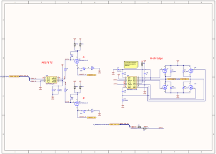

Figure 5 depicts the H-bridge and two MOSFETs for the external board. The H-bridge is driven by a driver (MIC4604), which is an 85 V Half Bridge MOSFET gate driver, along with two P-type (DMP3028LK3-13) and two N-type (NVD5C478NT4G).
The driver and the MOSFETs work together to control the direction and speed of a DC motor (actuator) or other load. The H-bridge can handle loads up to 30V/27A.
The two MOSFETs for switching high-current devices are controlled by a dual 4.5 A MOSFET gate driver (MCP1405), which is compatible with the same P-type MOSFETs (DMP3028LK3-13) used in the H-bridge. These MOSFETs can also operate at a maximum of 30V/27A, but they will not reach these values in our application.

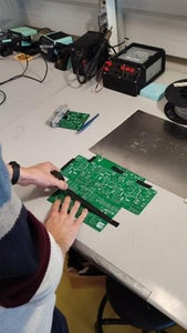

Step 5: Preparation Process for Solder Paste Application
In this picture is shown the preparation process of the PCB for the solder paste application.

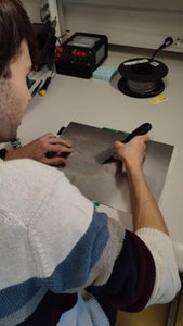

Step 6: Applying the Thermal Paste
Here we are applying the solder paste to the PCB with the proper technique and materials, and relying on the Stencil that JLCPCB made.

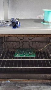

Step 8: Taking the PCB to the Oven
After the IC’s are placed, the PCB is put on the oven with our thermistor to control the soldering temperature to have the perfect solder joints.
