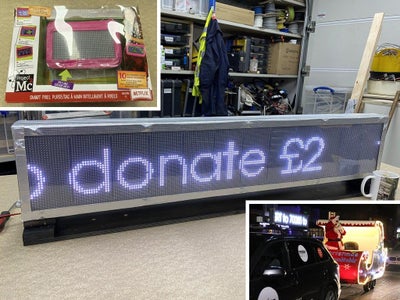

I am a member of the local Round Table and each Christmas we take Santa and his sleigh to the streets of Shirley collecting money for local charity's and give children a chance to meet Santa. This year with Covid restrictions we decided to offer the ability to donate by txt message or online but needed a means to advertise this while driving down the road.
At first we considered just a standard A frame sign on the roof rack but decided something more eye catching was in order. After a bit of discussion we decided a scrolling text sign mount to either side would be ideal but quickly ruled out purchasing one of a suitable size to be read at a distance on the grounds of cost.
This left us with the only option to make them (to be honest I was not to upset as it sounded like a fun project). I immediately thought of using the 75hub panels salvaged LED panels from Project MC2 Pixel Purse's, have used them for several escape room props in the past but needing 24 this seemed an extreme option so I first look for other purchasing option. I soon realised I had left it a bit late to order LED panels from Aliexpress and deciding they were just too expensive elsewhere I accepted that stripping down 24 hand bag was in my future.
Other design requirements were it should be water proof, run on 12v from the cigarette lighter socket and be able to be mounted to a standard roof rack.

With all this completed I setup a 8 panel prototype, it worked but there was a problem. I had hoped this would be enough but soon realised that more panels would be needed for the sign to be easy to read at the required distance. I decided that I would go for 12, the limit of what the budget could allow.
Step 6: Making a Waterproof Enclosure
The biggest challenge of making the enclosures was ensuring they are water tight but could still be serviced and the panels removed afterwards for use on future project but be returned to use for next year.
The overall dimensions of the sign where limited my the size of the polycarbonate sheet (1200 x 600) from which I needed to build two signs. Ideally I would of used a slightly larger sheet as it was slightly shorter that ideal for 12 panel sign but it was close enough to get away with.
A frame was made of pine the sized to fit 12 panels side by side. At this point I painted the frame all round to help the prevention of water ingress. The polycarbonate was cut to size and a series of holes drilled around the outside. A generous bead of silicone was applied and the panel screwed in place being careful not to over tighten the screws.
The rear cover was made made from some left over phenolic ply from a previous project. As I wanted to be able to remove this in the future rather than bed it on with silicone I use foam draft excluder tape to form a gasket.
The Pi and bonnet sat in small waterproof box I attached the the rear of each sign so the could be access easily without needing to disassemble the whole thing.
The whole sign was raised off a mounting board by a couple of wooden blocks, rather stupidly in a rush I didnt pilot drill then and they split, they did however hold up for the two weeks they where in use.
Step 7: Assembly
Assembly is simply a matter placing the panels in the frame, and screwing them in place using two clamping strips. Make sure the arrows on the panels all line up and daisy chain the panels using the IDC cables making sure you daisy chain the in the direction of the arrows.
Once thats done you just need to add the extended power cables built earlier, seal up and you are ready for a final test.
At this point I got a little nervous that the silicone sealant and foam tape were not going to be sufficient to water proof the enclosures so I added rubber tape.
Step 8: Final Test
I this point it was pretty much completed so was time to test, I set a current limit on the power supply just incase I have made a mistake somewhere, but surprise surprise it just worked first time! I would point out that the power consumption was much lower than I expected and a 10A buck converter was massive overkill!
Step 9: In Place on the Vehicle
The signs were mounted to the roof rack using a U bolts designed to mount a roof box. This meant they could easily be removed for repair or maintenance if need be. Taking a picture of the signs on proved a little difficult but you get the idea!
