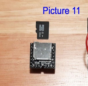

Step 5: MP3 Player
Next, connect the MP3 player (picture 11) on your Breadboard. I recommend using the DFRobot MP3 player, or one very similar. I have used a different player in the past, but it needed an external amplifier to get any sound from it. There are several tutorials for using the DFRobot MP3 player, so I won’t go into further details about using it here.
You will need to add some sound effect(s) to the microSD card. All android devices have a microSD slot that you could use. I use my computer, but you might need an adapter to plug into your computer. For the sound effects, you can record them with your device and save them as an MP3 file to the microSD card. You should have some “Voice Recorder” or “Audio Recorder” already on your device. Alternatively, you can search the internet for free mp3 files and saved them to the microSD card. There is a way to program the MP3 player to play specific sounds for specific events (like getting hit, healing the damage, losing the game, turning lights on, etc.) but to keep things simple I have kept it to only shooting sound effects.
Now that you know the MP3 Player works, remove it and the connections from the breadboard but keep the LEDs and the Bluetooth module. This keeps thing simple as you move on to the next component.
