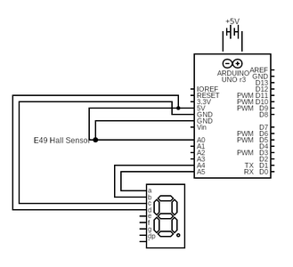

Step 1: Building the Circuit
The circuit is build as depicted in the picture. The display is connected to the breadboard for power and to the Arduino pins A4 and A5 for the display information transfer. The E49 Hall Sensor is connected to the breadboard for power as well, however the third wire of the sensor is connected to the A0 pin of the Arduino. Power is provided to the breadboard by two wires from the GND and 5V pins. The Arduino is subsequently connected to the battery pack, in which 6 AA batteries are to be placed.
(Since it was not possible to show a breadboard in the figure above two wires overlap. This thus can easily be solved by building the circuit with a breadboard and the instructions from above. The display is represented by the display component in the bottom right of the figure.)

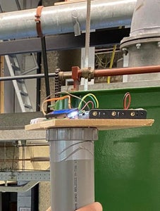

Step 3: Building the Upper Structure
Thirdly, the main structure of the device is made. The PVC tube is to be connected to an PVC end cap and a wooden board, on which the circuit is placed. The PVC tube is connected to the end cap by pushing it on, while the wooden board is connected to the cap with glue.
