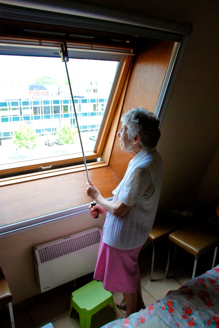

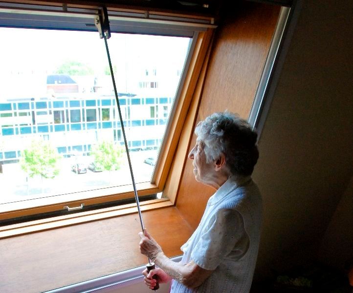

This product was specially designed for an elderly woman who had troubles with opening and closing her velux-window is her service-flat. However, the product can be used by everybody who thinks a velux-window is hard to handle.
We made a product that can be mounted on the handle of the window. By creating a momentum, the velux can be opened and closed with far less force than normal and is much easier in use.
This easy to make and really cheap product can be the solution to your problem!
We added a video so you can see the problem and solution.

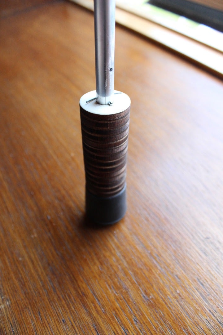

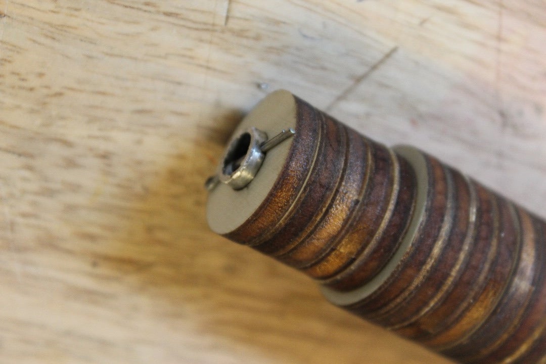

Step 6: Make the Handle
NEEDED
  • 15 wooden circels
  • 2 cotter pins
  • aluminium tube
HOW TO MAKE
Put one cotter pin through the hole with diameter 2mm (the middle hole). After that you can simply slide the 15 wooden circels in it's place like shown on the photo's. Start with the 10 big circels and then the 5 little circels. If you have measured correctly and have done everything right, the last circle you slide on the tube, will just touch the other hole of 2mm diameter. Put the other cotter pin in that hole and all the circels are fixed. You can bend the legs of the cotter pin as shown in the pictures. The circels can rotate around it's own axe, but are fixed in the direction of the length of the tube.

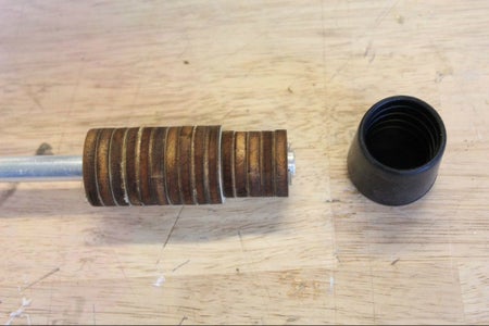

Step 7: Attaching the Chair Leg Cap
NEEDED
  • the aluminium tube with the cirkels mounted.
  • the chair leg cap
HOW TO MAKE
We do not want to make any damage to the Velux, so we attach a rubber cap on the end of the handle so the aluminium won't scratch the velux. It is also a good-looking finish.
This step is really easy. You take the chair leg cap and just mount it on over the little circels. You need to push it until you don't see any little cirkels anymore. By the design of the chair leg caps, it won't fall off because it will be fixed on the circels. If it falls off, you can glue it in to place if you want.

Take one metal bolt and start placing the wooden parts on it like the photo's show you. Start with 2 big pieces, then the 3 smaller pieces placed upside down and end with another 2 big pieces. As you can see, we create a square hole. Hereby the VeluxHelp will be firmly attached to your window's handle as seen in the last picture. Take the screw nut and tighten the wooden parts securely together.
Now we will attach the aluminium tube with handle to this wooden part. Start with another metal bolt and go trough one side of the wooden part. After you did this, go with the hole of the aluminium tube trough this bolt. After this you can end with going with the blot trough the other side of the wooden part. If you did this correctly, you will see that the aluminium tube can rotate around the bolt, but is stuck between two wooden parts. Screw the screw nut on the bolt and the VeluxHelp is ready for usage!
Notice that with only 2 bolts and nuts, we have put together the whole product. So it's really simple to remove or to put back on the window. It's literally 2min work!
