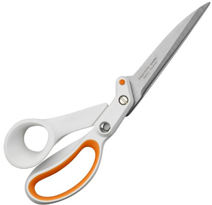

  1. Sharp scissor preferably a heavy duty

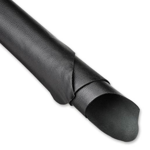

  3. Goat leader (1 - 1,5mm thickness)

Use a scissor or a heavy duty scissor depending on the veneer wood species hardness. I uses a heavy duty scissor for the oak but for the beech I can use a normal kitchen scissor.

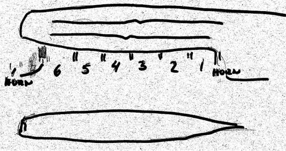

Step 6: Make Round Holes Squared
Take:
  1. 1 piece of 1 mm thick horn
  2. 1 piece of 4-6 mm thick horn
  3. 6 piece of the mall veneer pieces
  4. 6 piece (3 x 5 cm) of the goat leader
On the picture above I have decided to make a angle on the veneer piece that follows the knife blade.
Each hole has a angle of ~20 degrees.
  1. Start by laying out the pieces (horn, veneer and leader) and draw the tangs shape on each veneer piece.
  2. Start with a thin piece of horn. Cut it to size and drill a hole and file it to the size of the tang.
  3. Drill a hole that is approx the size of the smallest dimension of the tang. I use the vise to hold the small pieces when drilling.
  4. File away so the veneer piece fits on the position it's going to have on the tang. Here can a vise be helpful to hold the mall veneer piece when filing.
  5. Cut a hole in the leader piece that fits the position on the tang. I use a X-ACTO knife to cut a squared hole in the leader.
  6. And repeat the process for the next layer.
  7. The end of the handle is a thicker piece of horn (just for visual effect) and this piece has no hole in it. o cut a piece of an estimated size. Use sandpaper (120 - 1000) to make the side facing the end of the handle into a smooth finish.
Note! I start with a horn piece to get a more stable start on the knife handle than the veneer can provide. Just do a squared hole in the same way as the veneer pieces.
