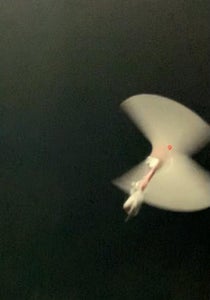

Cut out a long strip of cardstock paper. Mine was approximately 8.5"x1.5". Cut out a small, diamond shaped hole in its center.
Thread the LED end of the pencil body through the hole, leaving an inch of plastic body visible. Fold the rotors in half (width ways) as shown in the picture and then fold it in half long ways (also shown in the picture).
Use hot glue to connect the base of the rotor blades to the pencil body. Then follow the last two pictures to give the rotors the shape that will help them rotate well.

Step 9: Launch!!!!
Congratulations!!! You've officially completed your very own Venetian LED Helicopter.
Find a clear launch site outside. Hook one end of the rubber band around the end of the pointed pencil tip with one hand, holding the end of the pencil body behind the rotors with your other hand. Holding the far end of the rubber band, stretch the rubber band to full tension and then release your grip on the pencil body. The copter will rocket skyward!
Watch our video to see our copter head for the stars.
Enjoy!!
Note: The glowing effect will be magnified if you launch in the dark.
