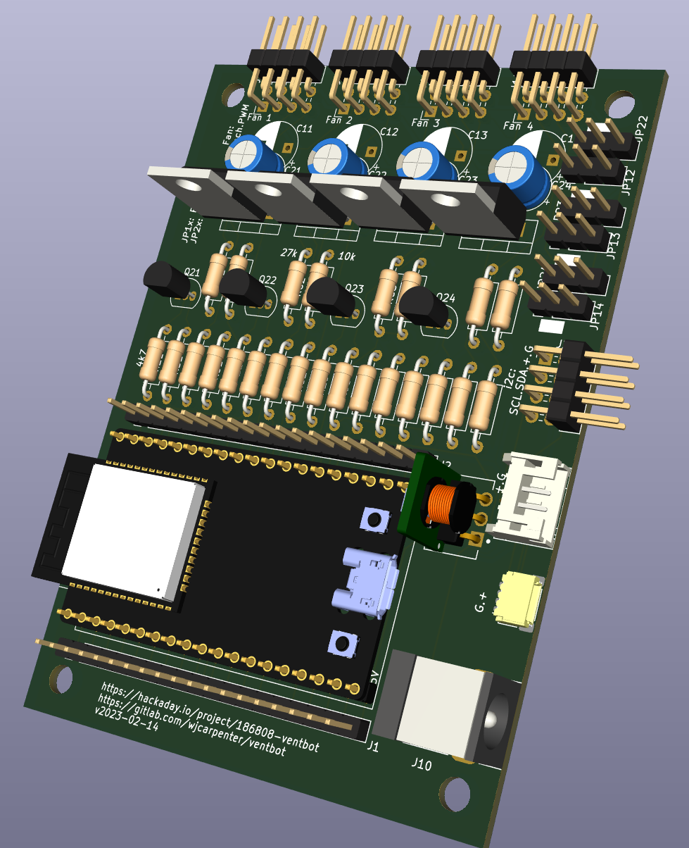

  1. There's a printed circuit board (PCB) with various components to be placed on it.
  2. One of those components is an ESP32 microprocessor module. You'll be putting custom firmware onto that module.
  3. There are connectors on one end of the circuit board for connecting the cables from the fans.

Step 4: PCB: Assemble the Circuit Boards
Once you have the circuit boards from the factory and have most of the parts on hand, you can begin assembling the boards. The images accompanying this step show a board that I have mostly assembled, and a 3D rendering of the board from within KiCad. There is also a generated 2D graphic showing the entire board with component locations.
There are a few general rules I follow when assembling any board (these rules actually compete with each other for priority):
  1. Assemble the trickiest parts first, in case you have to give up and start over with a blank board.
  2. Assemble the shortest/lowest parts first. This tends to help things stay in place as you flip the board over and back. You also don't have to work your way around taller parts to manipulate shorter parts.
  3. Save the expensive parts for last. This is in case you make some grand mistake and decide to start over with a fresh empty board. In this design, the ESP32 module is expensive compared to the others, though only relatively. More importantly, its 38 pins make it difficult to remove once it's soldered in place.
Another rule that I sometimes follow (and sometimes don't) is to assemble the really cheap parts just in case, even if I don't plan to use them. For example, resistors are pretty cheap, so I would typically solder them all in place even though I plan to use only 3 of the 4 fan positions.
Here is the order that I would assemble things for this board (this is also the order for the individual "PCB" steps that come after this step):
  1. If you are going to use the JST-SH connector, solder it first.
  2. The small NPN transistors (Q21-Q24).
  3. All resistors, in any order.
  4. All of the other connectors around the board edges, in any order, and the pin headers for the option jumpers (if you elect to use them).
  5. The electrolytic capacitors (C11-C14).
  6. The large MOSFET transistors (Q11-Q14) and the voltage regulator.
  7. The ESP32 module.
  8. Pin header strips J1, J2.
I usually place a few parts, then solder and clip the excess leads. If the part is a bit wobbly, I might hold it in place with a small piece of tape until I get it soldered. For parts with several legs, it can be helpful to solder a single leg in place, then push it gently as you reheat the solder to get it exactly where you want it. That soldered leg will hold it steady while you solder the other legs. (Be careful when pushing the part and reheating the solder. Some parts are really good at transferring heat into your fingertips.)
The large MOSFET transistors are oriented so that you can lean them over "on their backs" at an angle to reduce the overall height. These transistors have a tab with a hole in it for attaching a heat sink, but it's not needed for the amount of power that they are switching in this design.
Because of the large number of pins, the ESP32 module can be tricky to place. The redundant pins that are companions of the ESP32 (J1 and J2) are completely optional. I might populate them anyhow since the pin header strips are extremely cheap, and it's more convenient to solder them now than later if I decide I want them.
Each of the "PCB" steps below includes a graphic showing the board and highlighting the particular components for the step. The graphics were generated by the Interactive HTML BOM plugin to KiCad. As the name implies, you can also use it interactively to help you keep track of things as you populate the circuit board. To do that, open this page in your web browser: https://wjcarpenter.gitlab.io/ventbot/ibom.html. You can also download that page and open it locally in a browser. As you mouse over a line in the parts list, the corresponding board locations are highlighted in red.

Step 9: PCB: Resistors
The resistors all lie flat against the circuit board ("axial" orientation) and so have the shortest vertical profile. Therefore, it's a reasonable idea to solder them before most other parts. All resistors are for signal conditioning or current limiting, so ordinary 1/4 watt resistors should be fine. For the resistors that are 4.7k ohms, the precise value is not critical, so you could use something else if you had them on hand.
Resistors do not have an electrical orientation, so it doesn't matter which way you place them. The colored bands on the resistor body indicate the resistor value and tolerance. You might like to place them all in the same orientation so that it's easier to read the colors later if you have the need. It will also satisfy your human need for tidiness!
When placing resistors, my personal preference is to work with a single value at a time. I find I'm less likely to make a mistake in putting a resistor of the wrong value in a position. The long row of resistors are all 4.7k ohms, which should make it easy to avoid a mistake with them.
For each resistor, bend the leads at a right angle a millimeter or two from each end. Push it through the holes on the circuit board and gently tug from the back side until the resistor lays flat. Bend the leads out slightly to hold the resistor in place. I usually do a few resistors at a time. Place them on the board, bend the leads to hold them in place, solder them, and then use a tool to clip the excess leads off.
PWM signal conditioning
One of these resistors limits the current draw from an ESP32 digital pin to the base of the small transistor that switches the PWM control signal of a fan. The other resistor in each pair is a pull-up resistor for that same signal. The PWM ("pulse-width modulation") signal controls the speed of the fan.
If you use the jumper option to share the PWM signal from Fan 1, then you can omit these resistors for fans that don't have their own PWM signal. And, obviously, you can omit these resistors for any fans that you will not be using. Resistors are pretty cheap, so, if in doubt, place them all.
  • 4.7k ohm:
  • R21, R31 (Fan 1)
  • R22, R32 (Fan 2)
  • R23, R33 (Fan 3)
  • R24, R34 (Fan 4)
MOSFET gate control
The MOSFET transistor (explained in a later step) controls power flowing to a fan. This resistor limits the current draw from an ESP32 digital pin to the gate of the MOSFET.
If you use the jumper option to share the power from Fan 1, then you can omit these resistors for fans that don't have their own power. And, obviously, you can omit these resistors for any fans that you will not be using. Resistors are pretty cheap, so, if in doubt, place them all.
  • 4.7k ohm ohm:
  • R41 (Fan 1)
  • R42 (Fan 2)
  • R43 (Fan 3)
  • R44 (Fan 4)

Step 11: PCB: Connectors and Jumpers
Along two edges of the board, there are several mechanical connectors for various things. The pin headers for jumper selections are also located along one of the edges. You can place these parts in any order, but for discussion we'll describe them in clockwise order.
Fan connectors
These are only needed for the fans actually being used. Because these connectors use a common 0.1 inch pitch, you have some flexibility in the part you use. The possibilities were described in the previous step.
The row of holes in the connector on the cable coming from the is not centered vertically. If you use right-angle pin headers, the thicker part of the cable connector will be facing down toward the circuit board. Check that there is enough room to actually connect the cable. You might have to bend the pin headers slightly upwards or do some wiggling of the cable to get them connected.
  • 4-pin 0.1 inch pitch right-angle header (1x4 or 2x4)
  • J11 (Fan 1)
  • J12 (Fan 2)
  • J13 (Fan 3)
  • J14 (Fan 4)
Pin headers for jumpers
In a hurry or can't decide? Skip these.
As mentioned earlier, there are options for sharing Fan 1's PWM signal and/or power to any of the other fans. That was described in an earlier step. Normally, each fan should get its own PWM signal and its own power-controlling transistor. You have the option with jumper blocks on these pin headers for any combination of fans 2, 3, or 4 to get those controls shared from Fan 1. (If you do that, the software automatically figures out what's going on.) Without doing anything, the choice has been made for you to not use either of those types of sharing. That's probably what you want.
Rounding the corner from the fan connectors, you will find 6 sets of pads for 3-pin headers for selecting PWM and power sharing options. Although the pin headers are organized in pairs of 3-pin headers, they are physically staggered on the circuit board so you don't accidentally put the jumpers blocks on inappropriate pairs of pins. There are small white rectangles silk-screened on the circuit board to mark the normal position (each fan having its own controls).
If you want to make the choice to use any of the sharing (or if you want to be able to change your mind later), then follow these steps.
  1. There is already a trace connecting pin 1 to pin 2 on each of the 6 sets of pads. The trace is on the top side of the board (the side with all the components on it). Use a sharp blade to carefully cut through the trace. There's a small white line on the silkscreen that you could use for guidance.
  2. Now that pin 2 is not connected to either pin 1 or pin 3, you must make a choice to connect it to one of them. You could use a small piece of wire soldered in place between pin 1 and pin 2 or between pin 2 and pin 3. (It should be obvious that the trace you cut in the previous step was doing the job of connecting pin 1 and pin 2.)
  3. Another option would be to solder in place a 3 pin header. With the pin headers in place, you can use a jumper block to connect pin 1 (farther from the edge of the circuit board) to the center, which is pin 2. If you wanted that fan to share a signal from Fan 1, you would use the jumper block to connect the center to the other pin (the one not indicated with a white rectangle, which is pin 3).
For PWM sharing:
  • 3-pin 0.1 inch pitch header
  • JP22 (Fan 2)
  • JP23 (Fan 3)
  • JP24 (Fan 4)
For power sharing:
  • JP12 (Fan 2)
  • JP13 (Fan 3)
  • JP14 (Fan 4)
Jumpers:
  • 2-pin jumper blocks: one for each 3-pin header (total of 6)
I2C connections
The design uses a temperature sensor to know when to turn the fans on or off. The temperature sensor is not mounted on the main PCB. Instead, it is expected to be connected via wires so that it can be placed into the opening of the vent duct work. Electrically, the sensor interfaces using the I2C protocol. Physically, the circuit board provides 3 different connector types. You only need to use one of them, and you can omit the others if you want to.
In an I2C circuit with multiple devices, the 4 wires are all in common for the devices. On this circuit board, each signal is directly connected to the same signal on each connector type. Two of the connector types, JST-PH and JST-SH, have a de facto standard order for the wiring. There is not a standard for the pin header connectors, but this circuit board uses the same order as for JST-SH (which is the reverse of the order for JST-PH). As a handy reference, "SCL.SDA.+.G" (SCL and SDA signals, positive voltage, and ground) is silk-screened on the circuit board near the pin header connector positions. The JST-SH and JST-PH connector footprints have an abbreviated form of that near them on the silkscreen.
Although you only need to use one of these connectors for I2C, the 3D printed enclosure has openings for all of them. You can modify that enclosure so that it only has an opening for the one you use, or you can just print it as-is.
Pin headers for I2C
One way to interface the I2C temperature sensor to the board is to use Dupont wires to connect to a 4-pin 0.1 inch pitch header. The board has holes for 2 sets (J25). You have choices for what you do here.
  • If you plan to use the JST-PH or JST-SH connector for I2C, you can skip these pin headers entirely.
  • You can use a single 1x4 block of straight pin headers in either set of holes.
  • You can use two 1x4 blocks or a single 2x4 block of straight pin headers.
  • You can use a single 1x4 block of right-angle pin headers in either set of holes.
  • (Recommended) You can use a 2x4 block of right-angle pin headers.
The reason I recommend the last option is because straight pin headers would mean vertical insertion, which is slightly awkward to use with the enclosure. You will need to modify the 3D printed enclosure if you do this. Using a 2x4 block of right-angle pin headers will give an extra I2C connector if you think of a use for it in the future. The only good reason to use straight pin headers here is because you have them already and don't want to bother obtaining the less common (but still easy to find) right-angle headers.
JST-PH connector for I2C
Another way to interface the I2C temperature sensor to the board is to connect to the 4-pin JST-PH connector (J22). These are compatible with Adafruit STEMMA and (more or less) Seeed Grove. The Adafruit article has a good explanation about Grove compatibility. Connectors are available for horizontal and vertical insertion of the mating cable connector. Either will work, but horizontal is easier to work with in this design. The silk-screened footprint on the board shows horizontal insertion. With vertical insertion, the cut-out notch should face away from the edge of the board. With horizontal insertion, the cut-out notch should face up, away from the circuit board.
Because it is a surface-mounted part and tricky for novices to work with, I described the JST-SH connector separately in an earlier step. If you plan to add the JST-SH connector, refer to that earlier step.
Power jack
The board should be powered by a 12 volt DC power supply. The most common connector for those power supplies is a barrel connector, and the board has a barrel jack to mate with it. The barrel connector should have a 2.1 mm center pin hole and a 5.5 mm outer diameter. (The jack typically gives the center pin diameters as 2.0 mm.) That's the most common size for those connectors, so if you bought one without checking, that's probably what you got.)
The footprint on the circuit board is for a specific part, but you will find many "no-name" equivalent parts that can use the same holes, perhaps with slightly different alignment to the edge of the circuit board. Here are some possibilities.
  • CUI Devices PJ-063AH. This is the exact part for the footprint on the board.
  • CUI Devices PJ-037AH. This is a less expensive part from the same manufacturer. It has a slightly different footprint, but I adjusted the holes in the circuit board so that it can be used.
  • DC-005 "no-name" jacks. This is a part number used by a zillion different manufacturers of DC power jacks. They are pretty inexpensive. I can't guarantee that the ones you get will match the holes in the circuit board, but the ones I bought did. Some of these come with a third pin that enables sensing if the power plug is inserted. This design doesn't use that feature, and there is no hole for that pin on the circuit board. If your jacks have that third pin, just bend it out of the way or snip it off.
  • There are barrel jacks that are intended to be mounted in a round hole in an enclosure or panel. They would be connected with wires to the circuit board. If you use one of those, which would require changes to the 3D-printed case, be sure to attach the wires to the correct holes. The hole in the center of the footprint is for ground, and the hole farthest from the edge is for 12 vdc. (The two holes on the sides of the footprint are just for physical attachment of the PJ-063AH and are not electrically connected to anything.)

Step 13: Decide: What Voltage Regulator and Heatsink
In a hurry or can't decide? Use a CUI VXO7805-500 or CUI VXO7805-1000.
The power for the fans and the overall circuit board is 12v DC. The ESP32 module requires 3.3v DC. There is an on-board linear voltage regulator on the ESP32 module (usually an AMS1117) that can convert the 12vdc to 3.3vdc. The complication is that a linear voltage regulator dissipates as heat (hand-waving) the energy difference between 12vdc and 3.3vdc. 12vdc is near the upper limit of what the particular on-board regulator chip can handle, and it can also get quite warm from dissipating that much heat. In fact, I've had a couple of cases of seeing the magic smoke being released.
To deal with this voltage difference, there is a space for an additional voltage regulator on the PCB. You can use this to drop the voltage from 12vdc to 5vdc, which is much easier for the ESP32 on-board voltage regulator to handle. (It's the same voltage you get when you power it with a USB cable.)
The image of the circuit board showing the placement of the voltage regulator in the next step is generically marked, but you should use one of these parts that performs the same function. Here are some options for what to do:
  • This is qualitatively the best option and is recommended. A few manufacturers make switching voltage regulators that can be used as direct replacements for the 7805 linear voltage regulator. Switching regulators are more efficient and dissipate much less heat than linear regulators. You will not need a heatsink with these. One example is the CUI VXO7805-500, but there are others. This regulator is only powering the ESP32 module and not powering the fans, so a modest capacity of a few hundred milliamps is sufficient.
  • This is an OK option but not ideal due to the heat. You can install a 7805 voltage regulator. This is a widely available and inexpensive part (the actual part number you find may have some letters before or after the "7805" because different manufacturers have different conventions). Just be sure you get one in a TO-220 package (the most common). Since this is also a linear voltage regulator, it will also dissipate heat. It's larger and more robust than the ESP32 on-board regulator. If it happened to fail, it's also simpler and cheaper to replace than the entire ESP32 module. Besides the heat, there are a couple of physical disadvantages of using a 7805.
  • To allow the most room for the heatsink, the 7805 will be standing kind of tall above the circuit board. That might mean you will have to modify the 3D printed enclosure for the height.
  • If you lean the 7805 on its back (be careful it doesn't contact anything else), it might make it difficult to get to one of the buttons on the ESP32 module.
  • This is the worst option. If you just want to take your chances and skip the extra voltage regulator (not recommended), you can just solder a wire between pins 1 and 3 of the voltage regulator footprint on the circuit board. Definitely avoid letting the wire contact pin 2 (the middle pin). Assuming you are taking the preferred option of using the switching regulator, just be sure it doesn't touch the ESP32 module, which is fairly close behind it.
If you chose to use a 7805 voltage regulator, in operation it will be somewhere between "warm" and "very warm, you might even call it hot". Although the 7805 is a mature and robust part, sustained heat is not good for any electronics. The usual thing is to add a heatsink. The tab on the TO-220 package has a hole specifically for attaching a heatsink. Here are some options:
  • You can take a chance and do nothing at all. Once you've got the 7805 and the ESP32 module on the circuit board, you can let it run for a while and see how warm the 7805 becomes over time. I'd let it run for several hours to be sure. If it gets only "warm" (so you can touch it with your fingertips with no discomfort), then you can probably skip the heatsink, but you probably will not be this lucky.
  • There are commercially available inexpensive heatsinks made to fit the TO-220 package. They are made of aluminum or some other metal, and they typically have fins or groves to increase the surface area to help shed the heat. This is the best option. There are also silicone greases and silicone pads to help with the thermal transfer between the 7805 and the heatsink.
  • If you are feeling adventurous, you can DIY a heatsink by using a screw and some nuts and washers. There is a picture in this section that shows one that I made while waiting for my mail-order heatsinks to arrive. If you make your own heatsink, the two things you want are lots of mass and lots of surface area. You should run the device for a few hours to see if your makeshift heatsink or the 7805 still gets too hot.
Step 14: PCB: Voltage Regulator
When you place the voltage regulator, whether you use a switching regulator or a 7805 linear regulator, there are 3 pads and two possible ways to insert it. Pin 1 is the pad closer to the power connector. For both the CUI VXO7805 and generic 7805 parts, you want to place them so that their more or less flat backs face away from the nearest edge of the circuit board. In other words, the back of the device will be toward the outline where the ESP32 module will go later.
Step 15: PCB: MOSFET Transistors
The PWM signal controls the speed of each fan. Most PC case fans will keep spinning slowly even if the PWM signal is set to 0%. To overcome that situation, N-channel MOSFETs are used to turn off the power supply to a fan if the PWM signal is set to 0%.
I used a particular MOSFET part, but there are many others that would do the job just as well. You want an N-channel MOSFET that comes in a TO-220 form factor, which is the most common. It must be able to switch power at 12 volts DC or higher, and it must be able to switch the amount of current the fan needs. Check the specs for the fans you plan to use; it will sometimes be printed on a label on the fan itself. Most will draw no more than 100-150 milliamps at full speed, and, in fact, most will draw considerably less than that. For fans that will have their own power control, that's the amount of current involved. For Fan 1, if it will be sharing power control with any other fans, you will have to add in the power consumption for those other fans for the Fan 1 MOSFET.
I originally used part STP16NF06L, which can handle 60 volts and 16 amps. This part is not recommended by the manufacturer for new designs, but I didn't have any trouble finding them in hobbyist quantities. Other commonly available parts that would also work include FQP30N06L, IRF540N, and many others. I am currently using IRF540N MOSFETs, which are rated at 100 volts and 33 amps.
UPDATE: Based on some helpful feedback (see the comments), there are better choices for this MOSFET. Even though I didn't have any trouble with the ones I chose, there might have been some luck involved. It's better to use a MOSFET whose Vgs(th) (gate threshold voltage) maximum is less than the 3.3v output of the ESP32 pins. One example is the IRLB4030, but there are many others, similarly affordable.
These are the parts with the highest vertical profile on the circuit board. The orientation of the holes allows for bending them over backwards at an angle to make things shorter. There is a metal tab with a hole on the back side of the TO-220 package. That tab should be oriented so it is away from the fan connectors and toward the small transistors placed earlier. You will find that the legs of the part are thicker near the main body of the part and narrower toward the ends. You can use needle-nosed pliers to bend an angle in the legs. You can do that either before or after you solder the part in place. Be sure that the part isn't touching anything else when it leans on its back. It should hover in the air. (Don't rebend the legs too many times, or they will snap off.)
  • IRF540N
  • Q11 (Fan 1)
  • Q12 (Fan 2)
  • Q13 (Fan 3)
  • Q14 (Fan 4)

Step 17: PCB: ESP32 Module and Pins
Finally, we come to the largest and most expensive component for the circuit board, the ESP32 module and a couple of pin headers to expose all of the ESP32 pins.
ESP32-DevKitC
There are many ESP32 dev boards around, but you need one that matches the footprint and pinout of the circuit board. This is the 38-pin version of the ESP32-DevKitC, which is also sometimes listed as ESP32-WROOM-32D or NodeMCU ESP32 (not the original NodeMCU, which was based on ESP8266). These sometimes have the wifi antenna sticking out off the end of the module, and sometimes they have the antenna positioned on the module board between the last couple of pins. The important part is the pin-out of the part. The footprint on the circuit board will accept either, and they both fit in the 3D printed enclosure.
If you look at the back of the circuit board and hold it up to the light, you'll notice that there is a solid layer of copper covering most of it. That's called a "copper pour" or "copper fill" and is just a good circuit board design practice. There is a rectangular area under the ESP32 antenna that does not have that solid copper layer. That's to prevent possible interference from the metal of the copper with the antenna electromagnetic emission pattern. You don't have to worry about this in any way. It's just interesting design trivia. I'm no expert in this area, but this article has some interesting insights. You want good wifi communications since you will be putting the entire Ventbot inside metal ductwork.
There are only two possible ways to insert the ESP32-module (and I don't mean "right" and "wrong", though that happens to be true). You should orient it with the USB port, which is not used in this design, near the circuit board power connector. You may find it a little tricky to get all of the pins into the holes at the same time, if they are even the tiniest bit out of alignment (and in my experience, they always are). What I usually do is try to line up the pins on one side of the module with the holes on the circuit board. Have them just barely started going into the holes. Then gently rock the module and squeeze the pins on the other side until they engage with the holes. This can take patience, and you might have to gently pry a few of the pins with a tool. Gently, gently! Be sure all of the pins on both sides are actually engaged with holes, and then slowly and firmly push the module into place. It will probably be a fairly snug fit. A variation of that technique is to start with one end of the ESP32 module engaged and then gently lowering the module as each pair of pin on opposite sides engages. (The process of placing this part always reminds me of the principle behind picking a tumbler lock.)
There is no need to trim the extra bits off the pins after they are soldered into place. The 3D printed enclosure provides room for them to dangle as-is.
An alternative strategy would be to place 19-pin female pin headers into the ESP32 module location and solder them. You could then simply insert the ESP32 module pins into those pin headers. The advantage is that there will be a little give in those pin headers, making it much easier to place the ESP32 module. There are two disadvantages. It makes the whole thing have a higher vertical profile, which might affect how you make the enclosure. And, your ESP32 will only be held in place by friction instead of a soldered mechanical bond, so it might work its way out over time due to vibration and thermal expansion and contraction. I would not recommend this approach unless you simply cannot get the ESP32 module directly inserted.
The ESP32 module has a small but surprisingly bright LED on it. Depending on the specific ESP32 module you have, it might blink intermittently while the ESP32 is running, or it might be on all the time. It's bright enough to make part of the 3D printed case glow. Since your Ventbots will be tucked away inside a vent cavity, that shouldn't be a practical problem. If you find it annoying, you can remove the LED. It's a tiny surface-mounted part that looks a lot like other components on the ESP32 module. When the ESP32 is powered on, you can easily identify the LED part. To remove it (with power removed from the ESP32 module), heat it with a soldering iron until the solder on both ends softens. Use a tool of some kind to flick the LED away. If any solder has splashed onto the ESP32 module, carefully clean it up with solder wick. In case you are wondering, there's a decent chance you destroyed the LED by overheating it with the soldering iron.
ESP32 extra pins
If you decide to place these, you should have a fairly easy time inserting each of them. You want the short ends of the pin headers to go through the holes from the top of the board, leaving the long ends of the pin headers available for connections. You could, in theory, use smaller segments of pin headers to make up the total of 19 on each side, but you will find that things look tidier if you use a single strip of 19 pins on each side. You might also like to do what I suggested earlier: solder one pin in place, then re-melt the solder while pushing the pins to stand them up straight and firm against the circuit board; finish by soldering the rest of the pins.

Step 19: PCB: Testing the Board
At this point, you have a fully assembled circuit board with the choices you made along the way. Now is a good time for a quick test. You should already have uploaded the ESPHome firmware to the ESP32 in an earlier step. You can use the ESPHome dashboard to observe the firmware logging as you do the testing. (If you didn't already do the first firmware upload in that earlier step -- tut, tut! -- you'll have to find a USB cable that will physically fit into the USB connector on the ESP32 module that is already soldered to the board. If you can do that, you can connect the cable to a PC and do that first firmware update now. Do NOT connect the 12v power supply and the USB cable at the same time.)
  1. Put the assembled circuit board on some kind of non-conductive surface (to prevent things on the back side from shorting out).
  2. (Optional) Connect your temperature sensor to one of the I2C connectors on the circuit board.
  3. Connect one or more fans to the fan connectors on the circuit board. Obviously, it doesn't make sense to connect to any positions for which you decided to omit parts from the circuit board. If you placed parts for all 4 positions, you can plug in all 4 fans for this testing phase, even if you plan to use fewer fans "in production" in your vents.
  4. Connect the 12 volt power supply to a wall outlet and then into the connector on the circuit board.
If you are experienced with DIY electronics, you know what comes next. If you don't know, here it is: As soon as you plug in the power supply, keep your eagle eyes and bloodhound nose on the alert for smoke, sparks, funny smells, or parts of the circuit board that are more than just barely warm. If any of those things happen, disconnect the 12 volt power supply immediately, and think about the choices you have made in life up to now. (If things didn't go well, my best advice is to go through each of these assembly steps again, one at a time. At each step, recheck your soldering to see that the pins of the part are actually connected, and that you haven't accidentally made a solder bridge to something else.)
If thing go as expected, you should see the following things happen as soon as you connect the power supply:
  1. There will probably be a little bit of random blinking of the on-board LED on the ESP32 module, or you will see the LED steadily on (which one depends on the specific ESP32 module you have). There's nothing to learn from this beyond whether it happens or not. If there is no LED activity, there is probably something wrong, either with the firmware or your assembly of the circuit board. Obviously, you can't expect to see any LED activity if you removed the LED from the ESP32 module.
  2. One or more of the fans might come on briefly (a few seconds at most). Whether this happens depends on the specific fans you are using. It will probably happen, but don't be alarmed if it doesn't. The few seconds is the period of time when the circuit is powered up and the firmware has not yet had a chance to switch the MOSFETs off to cut the power to the fans. Even fans of the same module might behave slightly differently in this phase.
  3. The firmware will go through an auto-discovery process to figure out which fans are present and which are sharing the controls of Fan 1. For the first part, each fan will come on in sequence for a couple of seconds and then turn off. For the second part, Fan 1 will be on and then Fan 2, Fan 3, and Fan 4 will be on if they are sharing controls of Fan 1. After a few seconds, all the fans will have been turned off.
  4. The collection of fans will power up and go through the configured ramp-up table (described in a later step), and then they will power down through the configured ramp-down table.
  5. At that point, the fans go under the control of the temperature sensor if you have one plugged in. If things are at a normal room temperature, between the low and high trigger points in the firmware, the fans will stay off. They will also stay off if you haven't connected a temperature sensor.
  6. The ESP32 module has two small push buttons on it. One is labeled "Reset" or something similar. On the Ventbot circuit board, it's the button closer to the power jack. Pushing that will cause the ESP32 to reboot and repeat the previous steps. The other button is typically (and confusingly) labeled "Boot" and is connected to GPIO 0 on the ESP32. If you push that button, the firmware will go through the fan ramp-up cycle. At any time, you can push the button again, and the firmware will go through the fan ramp-down cycle, eventually turning all of the fans completely off. About 5 minutes after the last button press, the fans will return to being controlled by the temperature sensor.
  7. If you want to test the temperature control, you can use a hair dryer or something similar to warm up the temperature sensor breakout board. You don't need to go crazy since the default high trigger is only 85 F / 30 C or so. You can also cool the temperature sensor breakout board with an ice cube wrapped in cloth. Just be careful to not get any part of the circuitry wet. Also be careful to not short out any of the exposed metallic parts of the sensor board.
You can see a demonstration of most of the above things in the video. (I added step 4 to the firmware after I made the video.) If all of that went well, congratulations. Your board is working. There's a later calibration step where you can fine-tune the temperature triggers and the fan ramp-up and ramp-down configuration.
