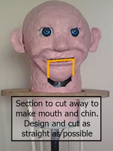

Using a hacksaw, cut a line between the lips.
The cuts down the chin need to be parallel and fairly clean for the mechanism to work.  I drew a centre line down at 90 degrees to the lips with a Sharpie and measured carefully on either side down to the bottom of the chin.  This section was then cut out with a hacksaw, and the edges smoothed with a sander until it would move up and down in a clean manner.
I then cut out five pieces of hardboard, two to fit inside the head and hold the chin piece in place, two to fix onto the sides of the chin cutout, and a piece to go along the top of the chin cutout, which I painted red to represent the tongue.
I got them as close to the profile of the pieces they were going to be fixed onto, then made sure it would all move properly (and worked out by eye where the pivots should be) before joining it all together with epoxy putty.

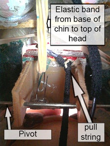

Once it was dry and solid again I sanded the joins down, made the holes for the pivots, and ran a length of wire coat hanger through for the pivot, just a sliver under the inside width between the cheeks, to be secured on either side with two more dollops of epoxy.
To get the mechanism to open and close, I first epoxied a staple to the base of the chin section and another to the top of the inside of the head, and joined the two together with an elastic band, just tight enough to keep the mouth closed, but with enough give to be able to open it with a fairly light pull on a string fixed to another staple at the back of the tongue.  A little more sanding and the mechanism was working quite smoothly.

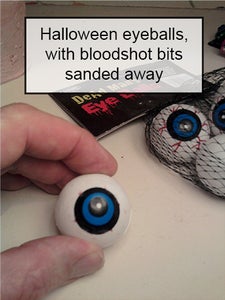

Glass eyes proved a bit expensive, ping-pong balls too flimsy, so I ended up dismantling a couple of old roller-deodorants and using the balls from those, which are made of quite firm plastic and will stand up to being drilled and glued.

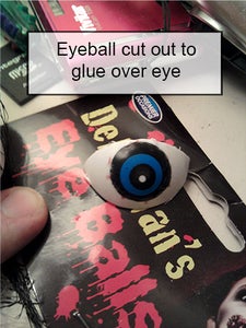

I tried colouring in the eyes, but couldn't achieve anything I was happy with, but last Halloween I found some fake bloodshot eyeballs in the pound shop.  I carefully sanded the bloodshot veins off, then cut out the eyeballs to glue over the deodorant balls.

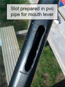

I clamped them together and cut a 22mm hole in the middle of each to take the length of pvc pipe into which the mouth mechanism is built.  Use a piece which is longer than you'll need to end up with, it's easier to cut it to size at the end than re-make the mechanism because it's too short (as I found out the hard way).

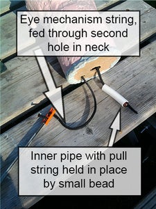

Drill another, smaller hole (roughly where the string to work the eyes is hanging down) for the eye mechanism.

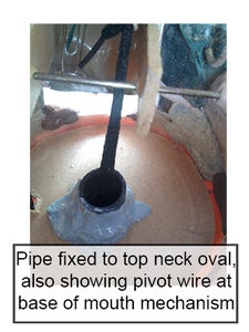

Once these are drilled and ready, fix one near the top of the neck and the other to the bottom of the neck with epoxy putty.

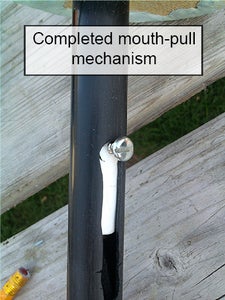

I worked out roughly where I'd be holding the pipe beneath the neck and moving the mouth with my thumb, and drilled a line of holes down, then cut the slot cleanly with a craft knife, finishing off with a bit of sanding to get a nice straight line.
You then need to find a short length of tubing (or a bit of dowelling) which will pass cleanly and smoothly through the pvc pipe.  Drill a small hole to take a self-tapping screw, (or whatever you're using for as the knob to work the mouth mechanism), which you don't fix in place yet.   Feed the string through the little pipe, and fix the string to it in a way that won't snarl the mechanism.
I used a small bead to hold the string at the bottom of the inner piece of tube.  Tie it loosely at first at the bottom to stop it falling out while getting the length of the string right.
At this point I marked off where the pipe needed to be fixed to the hardboard circles at the top and bottom of the neck, lined the hole for the screw up with the top of the slot, then marked off on the string where the knot needed to be for the mechanism to work smoothly.
Getting this bit right is mainly down to trial and error.  It's a bit fiddly, but not terribly hard once you've figured out what needs to be going on.

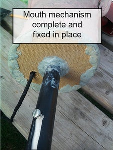

Once it all seems to be working, fix the pipe with epoxy putty into the neck, drop the mechanism back through the pvc pipe, and put the screw in to allow the mechanism to be worked by pushing gently downwards with the thumb.
Once you've made the body (next step) cut the pipe to the right length.

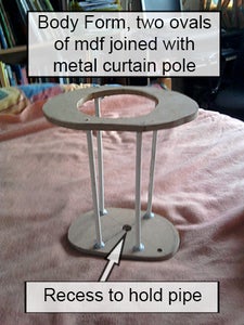

The body, generally being covered with clothes before appearing in public, doesn't need to be very sophisticated, just as long as it's roughly the right size and shape for them to fit over and look fairly convincing.
I took one of the children's old school shirts and used it to judge the size and shape for a couple of ovals onto some mdf, the top one slightly larger than the lower to give the faintest glimmer of a chest, and cut them out with a jigsaw.
I drew around the neck onto the top one and cut the hole out with some extra room to spare to allow the head to turn easily.
A recess is cut into the middle of the bottom one to hold the base of the neck-pipe, which needs to be supported while operating the dummy.
The ovals are then joined together with bits of metal curtain rod, measured against the clothes to get roughly the right height.
I drilled recess holes into the mdf using a bit very slightly larger in diameter than the rods and fixed them in with epoxy putty.
This is the point where you cut the mouth-mechanism pipe to size, so that it sits in the recess at the base of the body.

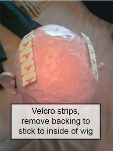

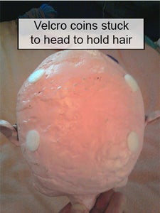

The wig is fixed on with velcro fasteners, which means that I can easily change it for other headgear in future, as well as being able to get to the cover at the back of the head for any maintenance which will be needed when elastic bands and string need replacing.
I've sewn the velcro into the wig to hold it in place, then put the hair on - and that's just about it!
