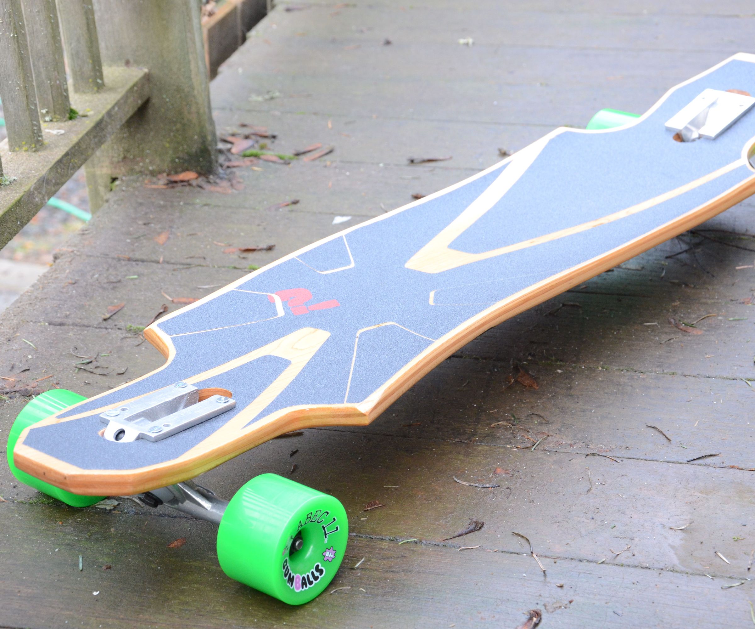

I have been looking at expanding my hobby and getting past the seemingly blocky or overly square manufacturing in woodworking. To that end I looked into finding better ways to shape or add dimensions to my projects besides hacking away at the material. I also liked the aspect of added strength from multiple layers.
This originally started out as an experiment to see how I could implement vacuum presses into my woodworking. Because of my haste, the end product isn't as seamless or pretty, however, this experiment has lasted and worked very well, so well that I see no need to upgrade in the immediate future.

Veneers. Veneering, like plating metal, allows you to use whatever form material you like and then glue thin strips of higher grade or designs over the surface. Traditional clamping methods can crease your veneer. If your surface it rigid all ready you can glue and apply your veneer to the surface and then place it all in the bag. you want to ensure a complete side of the bag is smooth along the flat surface. If the surface is curved you want to press over the convex bend. It can get extremely difficult to press into a cup or bowl and more often than not the bag will get snagged up on the edges or rim and provide virtually zero pressure in the center of the depression.
Forming over a mould. By using many layers of thin wood plys you can add more curves and shape and coincidentally strength than with single boards. You'll want to make a pre-shapped mould. I have cut a series of 2x4s smoothed them and screwed them together and I've built a box frame and used thin plywood or press-board. I've seen people shape concrete or other material as well. There are still many other ways, just ensure they are rigid and no trapped air (foam is a poor choice). Place the mould in the bag and glue up two plys or more at a time then line them up on top of the mould. Push out as much air as you can then toggle your chamber open to suck out the air. Once everything is the way you like it, run more air through your pump and open all your valves and watch your gauge. Continue to check your material in case it slides starts to crease or creeps under or between your mould and plys.
