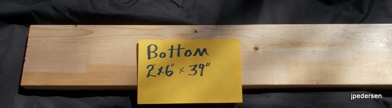

One 2 x 6 x 4 foot spruce

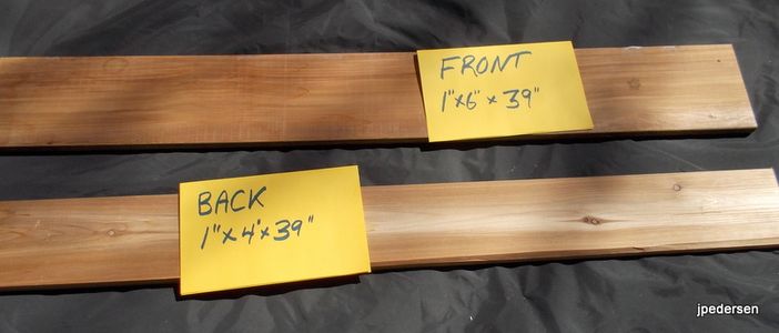

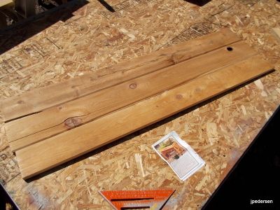

Step 3: Preparation for Construction

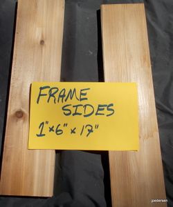

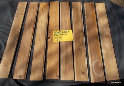

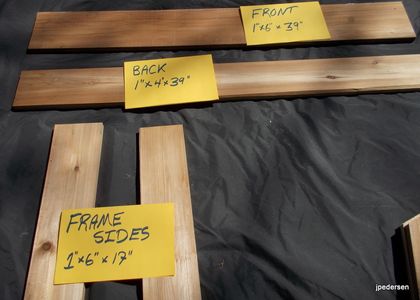

On 9 of the Cedar boards I ripped off the the Tongue and Groove using the table saw, the other 3 I just ripped off the Groove.

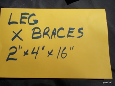

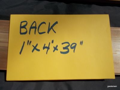

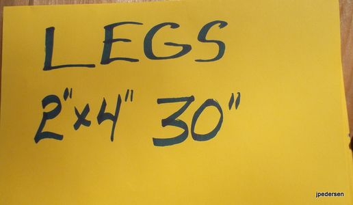

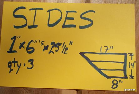

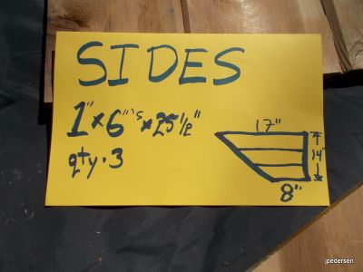

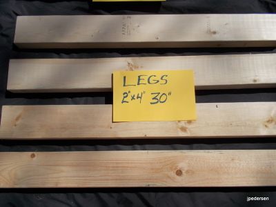

I wrote on the yellow paper the sizes of the pieces I needed and what part they were for.
NOTE! Some of the pieces used had their lengths changed during construction, they needed to be longer.
Luckily I had spare boards to make up for the short fall. I would suggest that the trim boards that go around the outside of the planter be measured for once the planter is put together.
Step 4: Construction and a Photo Hickup

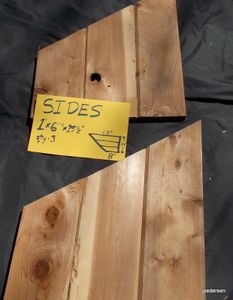

I cut to length the pieces needed and labeled them for present use and to allow others to make their own.

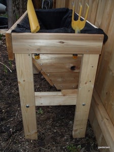

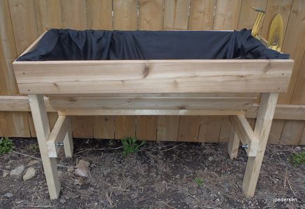

I went outside and took pictures of the finished planter with a different camera, so you can see how it turned out.
Step 5: Construction Continued

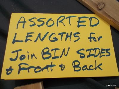

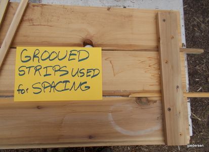

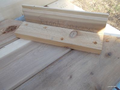

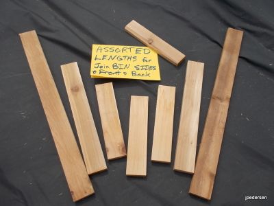

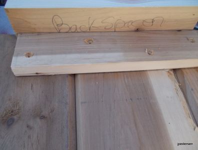

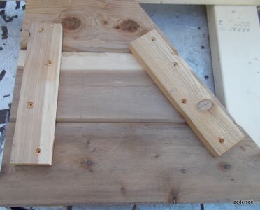

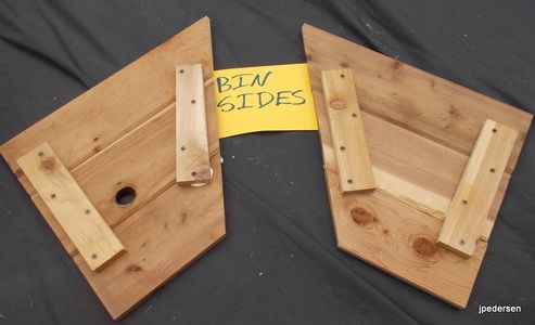

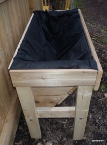

When I was assembling the front of the bin I used some of the cut off grooved pieces so there would be the proper spacing between the boards. Using some left over pieces that were cut off and then ripped in half, these were used to fasten the front, back and side panels together.

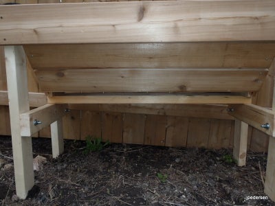

The legs and cross pieces were fastened together with the stove bolts and then attached to the the sides of the completed bin, the bottom of the planter (2 x 6) rests on the top side of the cross pieces of the leg assembly.

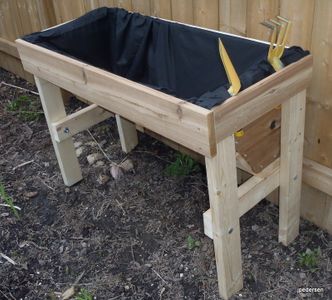

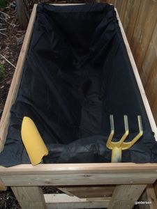

Finally I lined it with the landscaping fabric, the fabric is held in place with the Trim boards that are attached around the outside of the planter.

Step 6: The Finished Planter
I think it turned out quite good. The reason I liked this design comes from the advertisement description of it.
The front of the planter is shallow, good for plants with short roots like lettuce, the planter gets deeper toward the back so you could have medium deep roots and really deep roots all it the same planter.
Because it is made mostly of Cedar it's light and rot resistant, It's easy to put on a deck or a balcony and you can have a variety of plants or flowers in one compact easy to work on planter.
An added bonus is where the Trim side boards attach to the leg assembly this creates a narrow space where you can put small gardening tools when you aren't using them (see picture).
