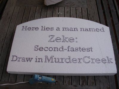

To start off, you'll need to create an epitaph (the lettering), preferably on the computer, and scale it to fit your styrofoam tombstone. Then, use the printout as a stencil and draw the lettering onto the foam. I've already used the hotwire cutter to cut the shape of this one.

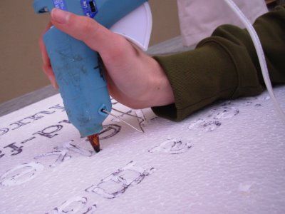

Next, plug in your hot glue gun and let it warm up. Then press the metal tip of the gun into the spaces where you want the letters to be, following their paths. The deeper you press, the deeper and wider the letters will be. Additionally, different hot glue guns have different angled tips, and will therefore give different results. When lettering, go slowly and evenly. After you have finished lettering, go ahead and pick off the stringy bits of melted foam left by the glue gun. Now all you have to do is paint your tombstone!

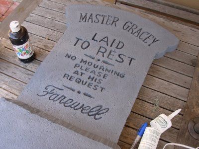

Step 7: Painting

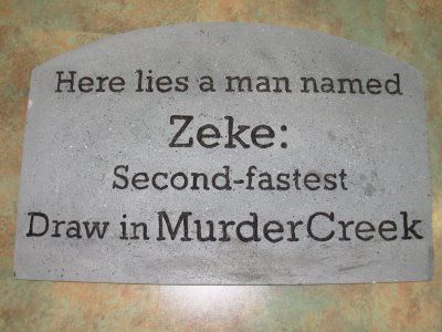

Paint in the letters with black paint. I used tempera paint (but acrylic is longer lasting). You don't have to stay inside the letters, since the main grey color will go on top. A small paint roller or large paint brush is useful for getting the main grey painted on evenly and without slipping into the letters. If you're using a paintbrush, make your strokes diagonally for this reason. I made my grey paint with some old white house paint and a bottle of black tempra.

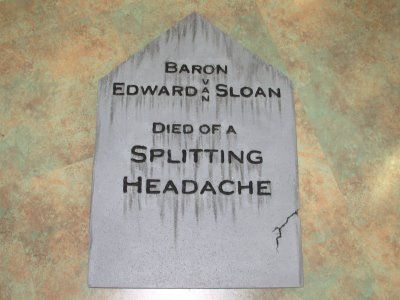

Detailing time! There are thousands of ways to bring a little more life into these tombstones. Here, I speckled black and white paint using an old toothbrush (you know, when you pull back on the bristles with your thumb)...
On Baron's tombstone, I put small blobs of black paint at the top, below the letters, etc., and wiped it down with a paper towel. Straight, downward strokes are key.
Horray! You've finished your tombstone! To show it off, you can hot glue a PVC pipe section to the back and stab a stake into the ground (or something similar). Happy haunting!
